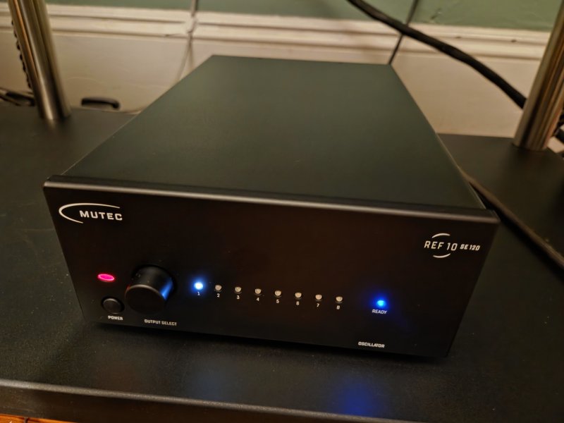

In connection with my previous Simaudio Moon 260 DT CD transport I had found the Mutec top 10 Mhz clock, the REF10 SE120, to be beneficial.
The Jay's Audio CDT3 MK3 CD transport is far superior to the Simaudio Moon 260 DT transport, see here for my initial impressions (post#613).
The CDT3 has excellent jitter specs of <1 psec -- a substantial part of its circuit is dedicated to reclocking. In comparison, jitter for the Simaudio Moon is specified at 115 psec (an Oppo has 800 psec jitter). The digital output from the Simaudio Moon had gone in my system through a Mutec MC 3+ USB reclocker, and more recently, through the Mutec MC 3+ USB fed and controlled by the Mutec REF10 SE120 as 10 MHz clock. This of course substantially reduced the jitter from the transport.
I must admit that the excellent jitter specs of the Jay's Audio CDT3 MK3 transport made me question if my Mutec 10 MHz clock still would make a difference, but this is the case. The phase noise of the Mutec REF10 SE120 is so vanishingly low that it still helps. When connected as external clock, the Mutec bypasses the internal OCXO (oven controlled crystal oscillator) of the CD transport.
From the Mutec website: https://www.mutec-net.com/artikel.php?id=1603308593
"With a phase noise value of < 120 dBc measured at 1 Hz offset from the carrier frequency of 10 MHz, the REF10 SE120 produces uniquely low jitter measured values of an average of <15 fs in the crucial measuring range between 1‑100 Hz."
See also the graph in below link: https://www.hifistatement.net/tests/item/2991-mutec-ref10-se120?start=3
(A measurement sheet like this comes for each individual unit received by a customer; mine looks very similar.)
And while my Mola Mola Tambaqui DAC apparently does its own internal reclocking as it upsamples to a very high speed data stream, it is not immune from incoming jitter in the digital signal that it receives (I assume few DACs, if any, are). In fact, a Mutec/Tambaqui set-up is featured here, with a streamer as source:
For removing jitter from the signal out of my Simaudio Moon 260 DT transport, which does not have an input for an external 10 MHz clock, I had used the following configuration:
CD transport > BNC cable to Mutec MC3+ USB reclocker, fed and controlled by external 10 MHz signal from the Mutec REF10 SE120. From the Mutec MC3+ USB the signal was fed via a second BNC cable into my Mola Mola Tambaqui DAC.
When switching to the Jay's Audio CDT3 MK3 I had initially kept the same configuration, and my first impressions (linked to above) were gathered listening that way.
Yet now, given that the CDT3 has its own 10 Mhz clock input, the simpler, and here tested, configuration is:
CDT3 directly fed by the Mutec REF10 SE120 > BNC cable from CDT3 to DAC.
The digital cable feeding the CDT3 from the Mutec REF10 SE120 is a Mutec PSC 50 cable (50 Ohm) via one of the Mutec's 50 Ohm outputs. While it is fortunately not very expensive in high-end terms, it has been measured to properly do the simple job that it is supposed to do, which is feeding a high quality 10 MHz square wave signal to the input, in this case the CDT3. Not any cable, not even any expensive one, is necessarily 10 MHz square wave ready (a different requirement from a 10 MHz sine wave, which a lot of other clocks operate with).
The 10 MHz input of the Jay's Audio CDT3 MK3 is specified as "50 to 75 Ohm". Initially I had used a Mutec PSC 75 cable (75 Ohm) via one of the Mutec's 75 Ohm outputs; a 75 Ohm connection from the 10 MHz clock is also used to the Mutec MC3+ USB. Yet after inquiry with Jay's Audio I was informed that a 50 Ohm connection was preferred. This is the above described connection that I used for the review. However, at this point I cannot confidently say that there is a significant difference in performance between using either the 50 Ohm or the 75 Ohm output from the clock into the CDT3. Admittedly, I have not done an in-depth comparison between the two options.
An active connection from the 10 MHz clock to the CDT3 is indicated with a small label "Ext.CLK" on the top edge of the LED screen of the CD transport, in the same size as for example "Repeat disc". Very nice.
Now on to some listening. Just as a statement upfront, the Mutec REF10 SE120 clock did not make a clearly audible difference on all music, in the context of my digital set-up, which is already very low in jitter to begin with, and of my system. However, as you will see, I find it very worthwhile for the kind of improvements that I heard, as in the examples described below.
I made sure that my impressions held up repeatedly and consistently on several different days; I am not a fan of reporting on subtle yet meaningful differences in sound and musical presentation in a casual manner.

I have to say that in general the Jay's Audio CDT3 is so good that even without the external 10 MHz clock it sounds better and cleaner than the Simaudio Moon 260 DT de-jittered with the Mutec REF10 SE120 clock controlling the Mutec MC 3+ USB reclocker.
Yet the combo of CDT3 with external Mutec REF10 SE120 10 MHz clock is the icing on the cake. After hearing the meaningful differences that it brings to the music, I cannot imagine my system anymore without the Mutec clock in it.
I received my unit, and the Mutec cables for it, from Alex Crespi at UpTone Audio who recently became a Mutec dealer. The service that Alex provides is impeccable and he was very helpful with answering all my technical questions in depth and great detail. Few dealers will have such technical expertise and will engage with the customer as much as he does.
