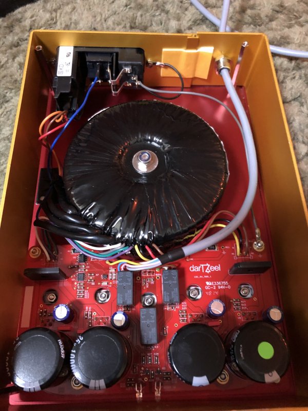

Mike, I would try removing the ground from the 18NS. I just tried grounding the phono input to my Shunyata Denali V2’s built in grounding system and the noise floor increased! I think this is because the 18NS is not connected to the AC mains unless the battery is charging. So by grounding it, you are now adding some noise, since the ground plane noise is not zero.
I just wired a ground wire (for now, 16AWG Duelund tinned copper) from a chassis screw on the 18NS power supply to the Denali 6000 v/2 ground terminal.
Results? Too early to tell but the noise floor did appear to drop slightly. It certainly didn’t increase as it did when I connected the ground wire to the Phono input ground (which doesn’t make much sense, at least in my humble opinion, for the reasons above).
Use this screw specifically- not all case screws on the PSU are tied to ground!

Thanks for the internal photos. The screw that I used has more room to connect a spade type connector for the ground wire.
Do you think the power supply is electrically connected to the preamp when the battery is powering it? DartZeel says no, I think; but there are reports that the AC makes a difference to sound quality, which shouldn’t be the case if the power supply is completely disconnected when running on battery power.
