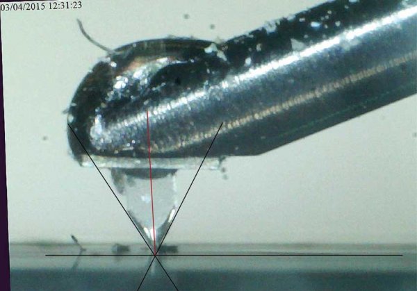

I have it mounted in my Kuzma 4point and XL TT. I use an USB microscope to check SRA and mini oscilloscope for setting azimuth.
The atlas is certainly the most sensitive cartridge (to incorrect azimuth) I have encountered not only when measuring but also listening.
Image and balance did not fall into place until the azimuth had been precisely set.

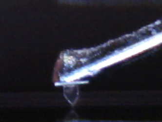

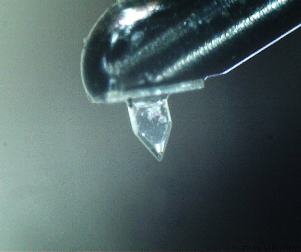

Congratulations, and I agree with jfrech, great first post. The photos are very good. It looks like the stylus is about 92 degrees relative to the tiny square plate at the end of the cantilever. I wonder if this is on purpose to achieve close to ideal SRA when the arm is parallel to the LP surface.

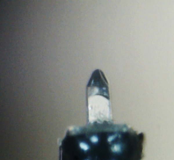

Here is a photo of my AirTight PC-1 Supreme
Hi Peter
Jonathon Carr leaves nothing to chance. I would absolutely say yes to the stylus position relative to the square plate - all part of the design to have the cartridge in its ideal position when the tonearm is parallel to the lp surface.
As has been mentioned, absolutely superb photo of the Atlas stylus.

Your supreme looks very similar to the Atlas cantilever construction.

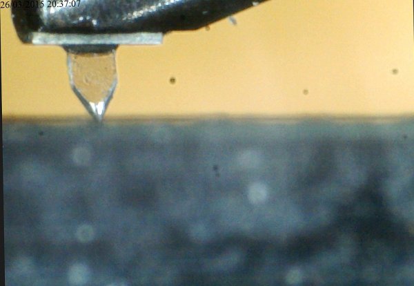

I have been experimenting with the SRA and have now found the best position by listening for; image, focus, depth etc.
Reassuringly the microscope shot seems to show the stylus rake at about 92/93 degrees.

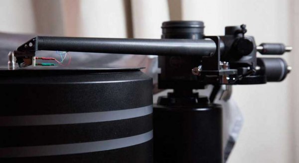

It does mean the arm is set well below the horizontal though, as can be seen in the photo below.

this is the SRA estimate photo
