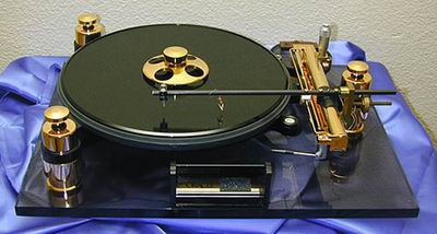

Luv this pic on the Oracle

I was thinking about Oracle the other day and figuring a linear setup would look so cool on that TT. Thanks for sharing the pic.
Although some people use air bearing linear tonearms with the Oracle (and I also used the ET2 on it), apparently it is a technical nonsense :) . The Oracle has an high compliant suspension, and when the arm moves the suspension tilts backwards as the mass of the tonearm moves from front to the middle of the turntable. In order to get the maximum from such a tonearm one should use a non bouncing, perfectly leveled and stable turntable.
As the Oracle looked and sounded fantastic with the ET2, we accepted to have to check the level very often. I read some people modified it, replacing the springs with elastomer blocks to use ET. But, IMHO, and Oracle without color coded springs is an oxymoron!
