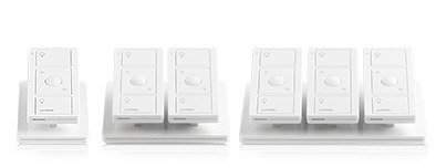

I agree with Tom - the Lutron Maestro dimmers are excellent. I have them all over my house including the audio room. What I find really cool about these is you can control them from almost anywhere, not just at the wall switch, using Lutron's Pico control which is a small wireless switch.
You can program a Pico to control any one or a combination of lights that are on a Maestro. With a bit of velcro you can attach the Pico almost anywhere. I put them at both ends of my long kitchen island under the counter. With two lighting circuits in my audio room I have a dual Pico tabletop pedestal next to my listening chair. I also agree that dedicated lines for the audio room are key.
