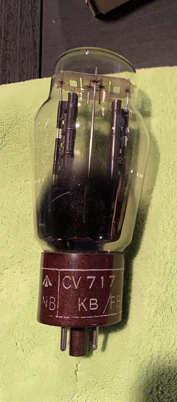

STC 5R4GY. Decided to get this based on Goran and Sfox7076 posts.
Brand spanking NOS. Nicely made. Looks promising. £45.

The getter rings are different and I think the plates are different. I once wrote a ton on the tube, but not sure I remember the differences now.
I won't make any assumptions about your assessment, then. Experience definitely tells me not to. It's not the same tube/valve. But for £45 worth a try.
I believe this is the Footscray one.

Is this Oldham or Footscray plant manufactured?
