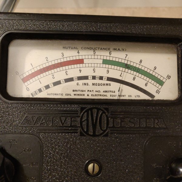

Nervous times on the tube tester.
RD27AS first. What we're looking for is 7ma/V for a new valve.
Sold by cipsnaj eBay rating 995 sales at 100% feedback. He declared these to test at 75%.
What did we get?
5.2 and 5.3 ma/V. Cipsnaj is an excellent seller. As bang on 75% as you could expect and it shows common agreement between testers.
It also shows that the guy who restored this tester knew what he was doing.

Now here's the PX25 test.
This just freaked me out. The Osram came in with flying colours at 7.2. The Marconi came in at 3.3.
WTF? Only two sections of the filament appeared to be lit. Tapped the valve. A blue spark emitted from the far left hanger. Tapped again. And again. More blue sparks.
Then... hey presto it sprang to life. All four sections lit as you can see. Phew! Close call.
Then perhaps unsurprisingly it measured 6.6 ma/V.
I am pretty happy with that TBH and it is better as a pair than a number of triodes I have bought new. Really.
30 minutes in the tester and it is still fine. Let's hope it stays that way.?
