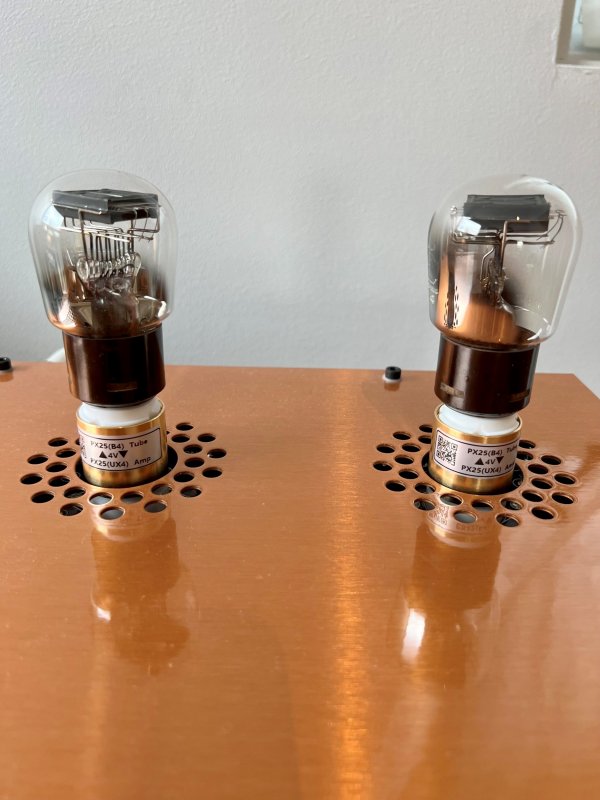

I just now ordered a NOS matched pair of Visseaux TMBF1, and a PX25 (B4) > PX25 (UX4) adapter.
Lampi optimized my GG2's at the factory to run 242's, so I am hoping the experiment works out. My daily driver are KR RK 242's and I am very happy with them.
I understand TMBF1 uses the same heater setting as 242?
Valvo AZ1 Mesh also just arrived today with adapter and now burning in (Telefunken AZ1 mesh on the way). To date, I've been running KR RK 5U4G and Takatsuki 274b in the rectifier position.
I think you want a UX4 to B4 adaptor, given the base adaptor in triode based Lampis is UX4. That may have been what you meant.
Nice, glad to hear your positive experience with the TMBF1. I'm looking forward to trying it.
Yes, B4 (Tube Pins) to UX4 (DAC socket). This is the adapter I bought.
Looks very close to what I use, if not the same. Nice and weighty quality Chinese socket and they have stood the test of time, unlike other efforts I have used from China.
