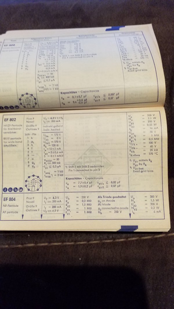

The p factor(Z) of this low-noise microphone pentode is under 1.5% failure rate. This means that only 1.5% of these tubes fail in (LL)10,000 hours of operation. This was guaranteed by Telefunken in Ulm. The EF 800/EF802/EF804S/EF806S tubes were used in studio microphones and studio power amps, e.g. Telefunken V69.
The letters in the blue dot (left) indicate quality requirements.
Z=1.5%failurate
LL 10000hours life guarantee
