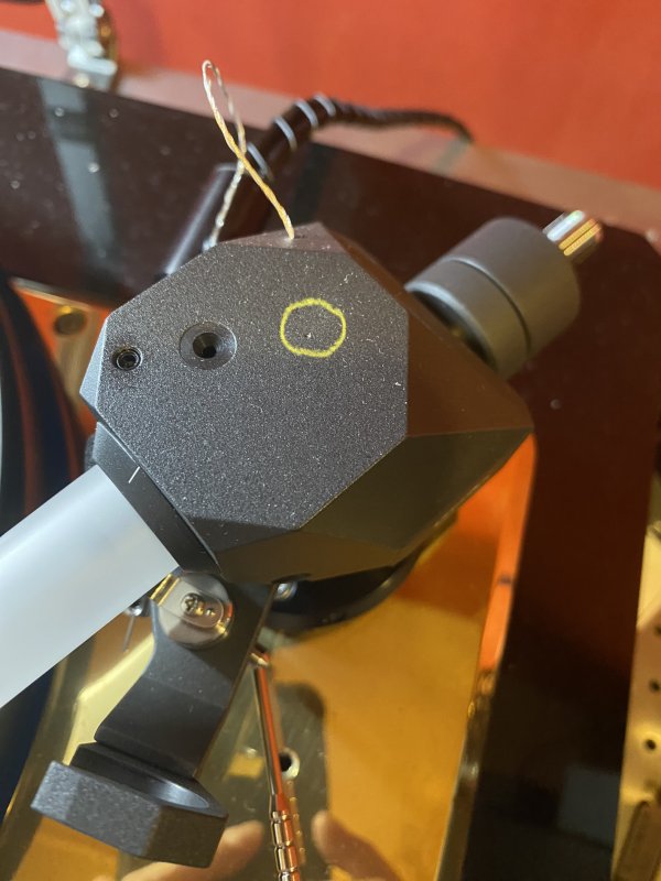

Maybe my concern is unfounded. I was curious about @phoni 's note that, as I understand it, says tools such as the Smart Tractor or Feickert are "mal-functioning" for setting up the tool using the pivot-to-spindle needle because a dimple or center point to hold the needle is covered by the tone arm assembly sitting over the arm tower. This is unlike the 4P models.
Is it correct there is no dimple on the top of the tone arm assembly? I don't see one in the pictures in the manual. Is there a dimple on the top of the arm tower?
It's not so much an issue for setting actual P2S distance, but rather for positioning an alignment tool on the platter to get its alignment pattern in the right position.
You said you have no problem doing that with your original Feickert where the P2S measurement jig is a separate piece. On the SmartTractor and UNI-Pro, that P2S jig is integrated with the flat piece that sits on the platter.
SmartTractor users or anyone -- could you explain how you get it correctly positioned? tia
Hi Tima, yes, there is a dimple on top to reference the pivot’s position.
Thanks for that photo -- enlarging it I see the dimple. It's v small compared to the 4Ps -- no wonder I did not see it in a manual picture, but it doesn't need to be large; knowing the spot is what counts. Seems quite adequate for setting up an alignment tractor.
