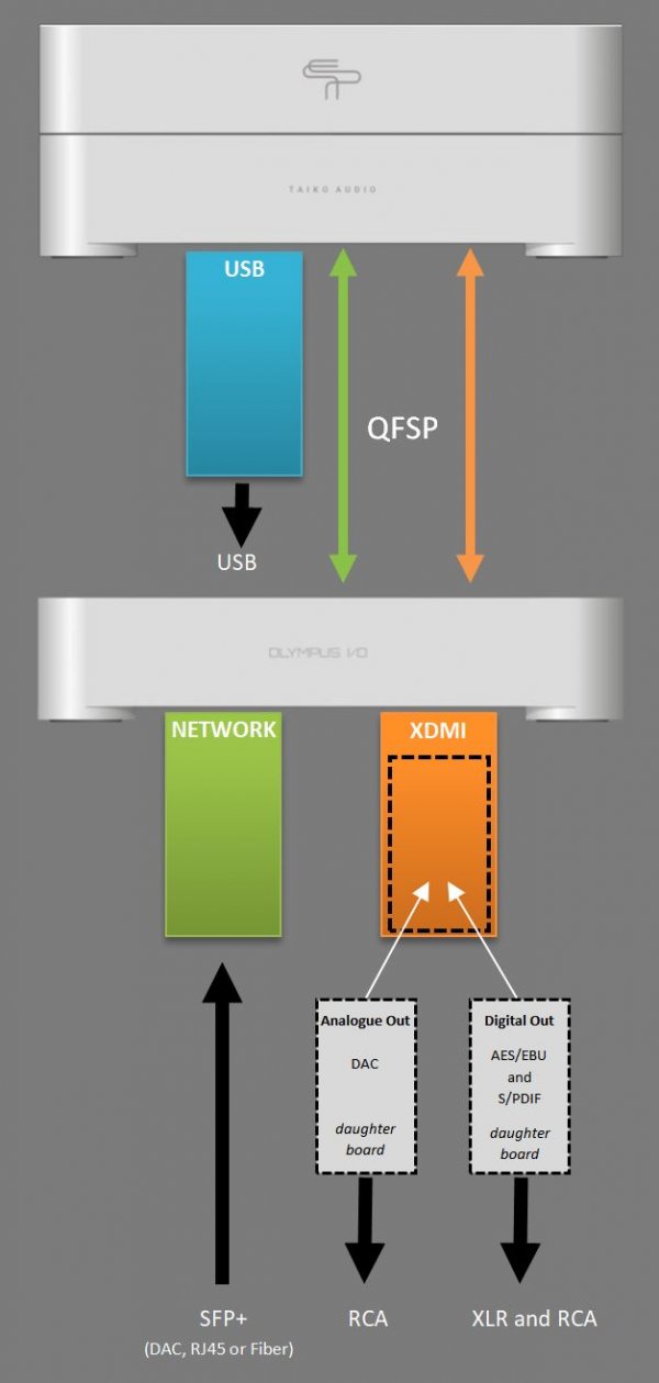

@Taiko Audio
Hi Emile,
Thanks for your reply.
But there's a doubt lingering in my mind.
Correct me if I'm wrong.
In the context of Olympus + Olympus I/O XDMI (plus USB)
it seems to me that it won't be enough space for the USB card.
Which means my little diagram below is not correct.
And therefore that the "full monty" config is not possible.
OLYMPUS SERVER :
Slot 1: combined for graphics and OS drive
Slot 2: "IN" card + QFSP cable
Slot 3: "OUT" card + QFSP cable
Slot 4: --- empty --- heat management
Slot 5: U.3 storage drive
OLYMPUS I/O :
Slot 1: XDMI
Slot 2: "OUT" card + QFSP cable
Slot 3: "IN" card + QFSP cable
Slot 4: Network Card
So, a priori, there's no more room left for the USB interface card.
What am I missing ? o_O
Thank you for your help :)
Cheers,
Thomas
The "full monty" config :)
@Taiko Audio
Hi Emile,
OLYMPUS SERVER :
OLYMPUS I/O :
Slot 1: XDMI
Cheers,
Thomas
The I/O interface card hardly produces any heat, I have no reservations about using slot 4 for USB in this particular scenario. The XDMI card with analogue outputs though does consume around 5-6 watts and does produce some heat. In all honesty though I just cannot imagine any future Olympus/XDMI owner would be even remotely interested in listening to USB.
Hey thanks for your quick reply!
In my case, the USB card will be used in parallel with the XDMI interface for a transitional period and for the fun of testing purposes, which I'll be sure to report here.
I don't doubt for a second that once we've tried the XDMI interface there'll be no looking back.:)
