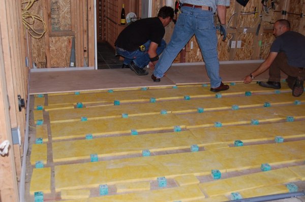

I have wood floors on Kinetics Noise Control blocks sitting on a slab. This did not work for my turntable. That's why my turntable and other sensitive equipment is in another, completely decoupled, room!
Hi Bruce!
How can a wood floor over a slab not work?
Hi Bruce!
There is an air gap of about 4" between the floor and slab. There are 3 "rooms within rooms" and the floors/walls/ceiling are totally decoupled from one another and the house. Floor.jpg

There is an air gap of about 4" between the floor and slab. There are 3 "rooms within rooms" and the floors/walls/ceiling are totally decoupled from one another and the house. View attachment 47627
A-ha! Now I understand. That looks interesting and complicated. The "room within a room" technique is a very high-end, luxurious way to go!

So is the turntable/stand now more directly on concrete slab?

Ive said that all along. I hired a structural engineer who knew the architect I used for my room design. He was inexpensive and knew immediately how to handle my room. My subfloor was built to tolerate a load of 1500 pounds per sq foot whereas in a residence the norm is 40--60. My biggest fear was one day to find all my gear in the living room below
