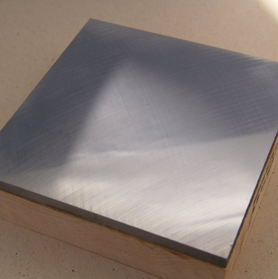

The top plate issue has finally been resolved. 1/2" carbon steel plate plasma cut. It will also be finished via a blanching process and powder coated clear matte. Gloss is an option as is color matching the stand's powder coat choice. They advised against unfinished steel for corrosion reasons. weight 25x36...136lbs
here is my quote and detail on the steel top plate and that does not include the blanch process ($250).
OPTION 1: Powder Coated Steel Top Plate
Additional cost for 0.5” thick powdercoated steel top plate: $385
Increase in price is due to:
Increasing the thickness of the steel plate (from 3/8” to 0.5”)
Increased complexity in mounting modules to plate
Requirement to plasma cut plate to size to prevent bowing/uneven surface flatness
Approximate weight of top plate: 128 Lbs
Additional load bearing springs required: $200
QTY 8 springs added at $25 per spring
10 Kg of additional load capacity per spring
Cutting aluminum plate to the current base shelf size: $85
Cost a result of 1 hour labor required to cut down plate using plasma cutter
This cost can be negated if we extend the plate to the entire profile of the frame, meaning there is no recessed area for the base shelf.
Total Cost for Option 1: $670

After going back and forth I finally settled on the best top plate material for this TT application...1/2” plain old carbon steel. Aluminum and Stainless are bad choices from a high frequency resonance ring standpoint from what I understand.

My reasoning is simple, it’s not needed & makes no difference to the sound so why waste money, it’s also easier to spray paint powder coated steel if needed than dealing with stainless. I don’t like aluminum because it’s light and has obvious resonance that add color to the upper bass, lower mid and the worst IMO are sandwich shelves made with aluminum trying to tame it with some kind of dampening material.
