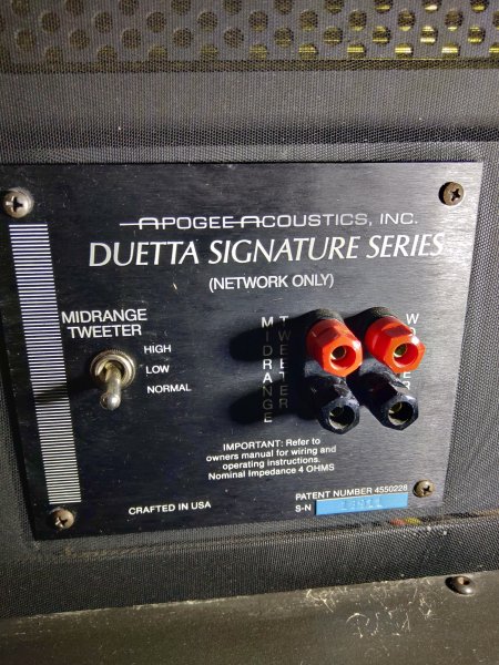

First off take two pictures. One of the speaker connections on the back of a speaker and one of the connections on the back of the amp.
BTW they are NOT Duetta Signatures. They are Duetta II but they might have had an upgrade to make them equivalent.
We'll worry about the bass panels and testing the speakers later. Let's just get them going first.

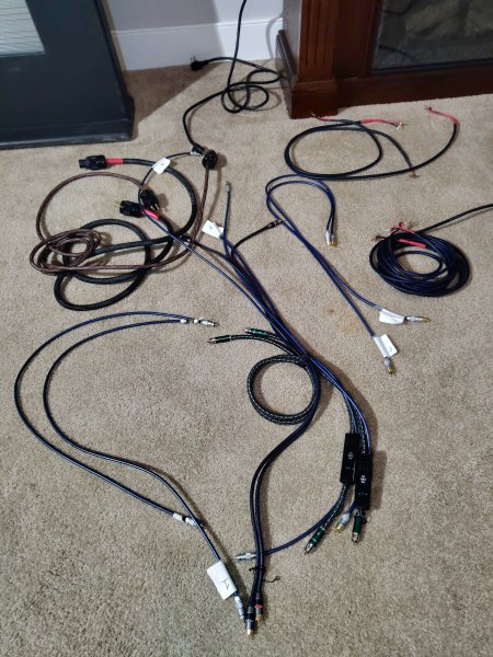

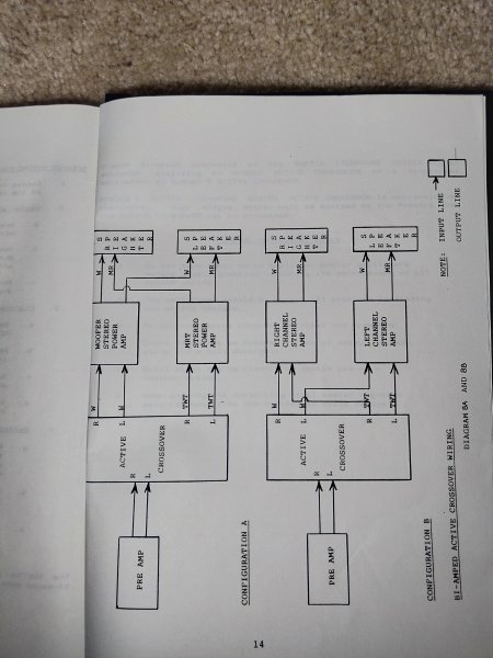

Here is the manual that came with them is this the diagram I should be looking for and I noticed that my cables are all numbered also I guess it's kind of self-explanatory just want to make sure what I'm doing and as far as cables this is what I have does it look like everything I need?

Anyway, if you haven't connected them up, it looks like you have some cable that might do it. The stuff I have marked in red on the attached pic.
For each speaker, connect the bass black and red and tweeter black and red terminals to the spades at the end of the cable with four connectors. The black and red of one pair of spades to the black and red of the speaker connectors e.g. bass and then the same for the treble, matching the colours.
Then connect the end of the cable with the two spades to the left or right channel of the power amp, matching the colours. Colour matching is VERY important, or the speakers will be out of phase.
That's for normal bi-wire cable however it looks like you may not have normal bi-ware cable, but four pairs of connectors, two at each end? If so say so if you are confused?

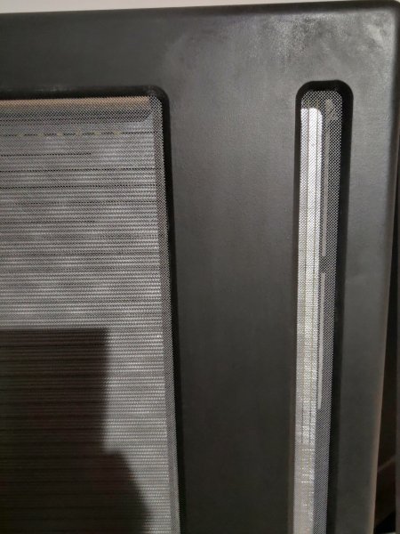

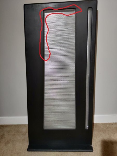

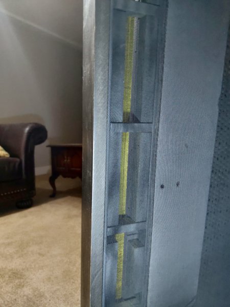

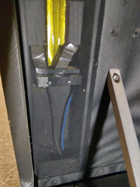

This is what worries me.
Can you take some close ups of this speaker around the area I have highlighted?

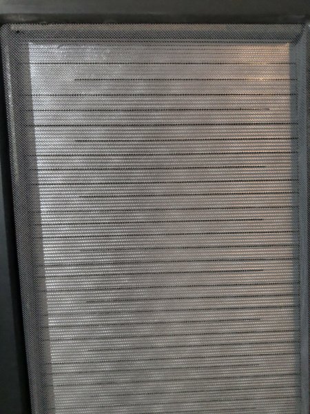

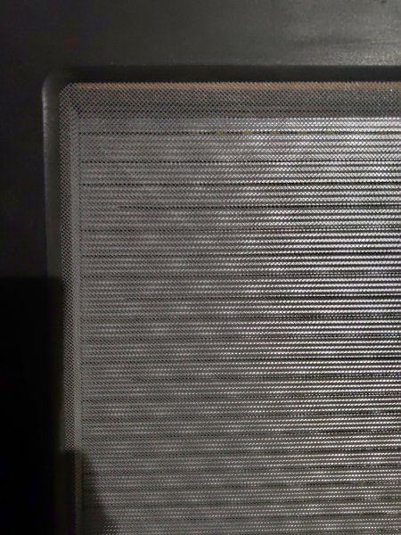

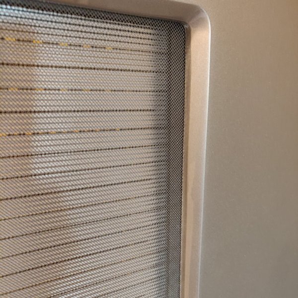

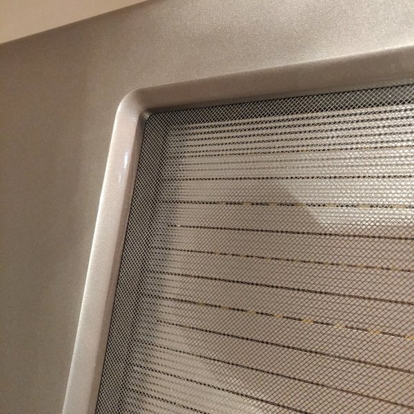

Here is the pictures you requested sorry it took so long Ben out of town. I was thinking about trying to maybe hook them up this weekend and get the amps up slowly?

Sorry for being so slow.

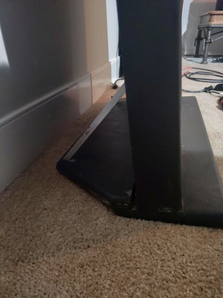

What is doing my head in looking at the pictures is that the bass panel clamps are quite plainly inside the perimeter of the front cover, and by quite a long way.
Take a look at the attached pictures. Although there's shadow, the clamps line up with the covers.
It is almost like the cover is incorrect for the speaker, or the bass clamps have been deliberately repositioned for some reason.
The pictures are quite low resolution so it is hard to tell, but the Kapton/foil bass ribbons look OK.
I will have a chat with the refurbisher to see what he thinks. He's seen far more pairs of Apogees than I ever have or will.

Zero000
Jul 28, 2014
2,987
1,141
478
Actually did you get them up and running? Did you run the test I was talking about?
Also, my pics aren't that great just mobile phone pics, but they are good enough to show what I mean.
EDIT: it may just be the cover is to high for the frame for whatever reason. A picture of the bottom part of the bass panel would help determine that.
