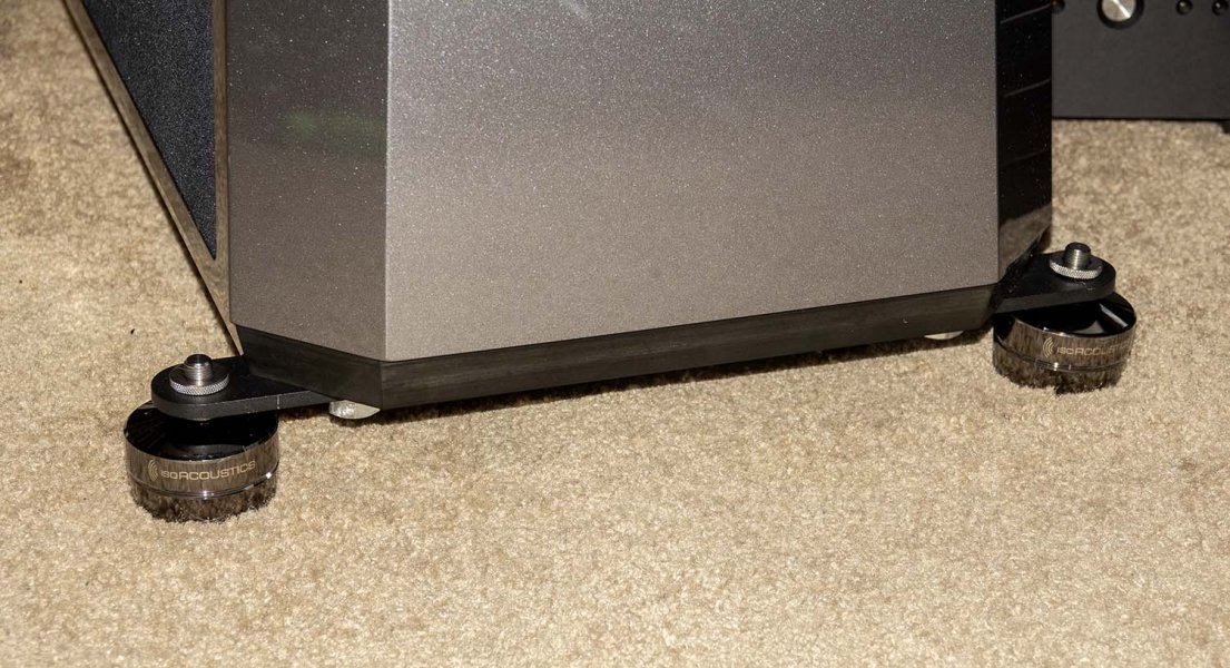

Bartolo, do be aware that the original thread in the top of the Gaia-I is M12-1.25, and that, of course, is the thread on the bottom half of all the stud-adapters. I'm currently adaping Gaia-Is to my Vandersteen Seven Mk.IIs which have 9/16-18 spikes, so I'm having to drill and tap that 12M-1.25 hole in my spike-bars. The box of 4 Gaia-Is includes a quad of straight, all-12mm, studs, so if your S5IIs have 12mm-1.25 holes in them, no adapting is necessary, just screw the studs into the Gaias and screw that assembly into the bottom of the speakers.

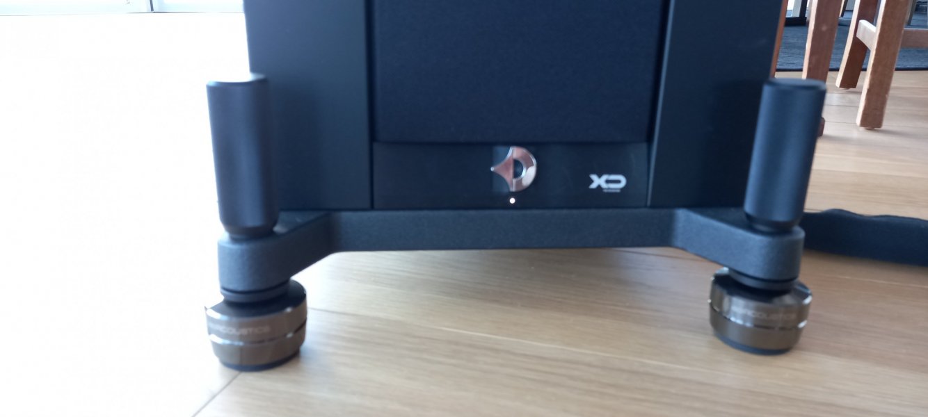

Gaia I feet under 100 Kg Avantgarde Duo XD speakers. A bit of a fiddle to remove the rather fancy spikes supplied and to fit the Gaias to the male threads of the AG's height adjusters, but a simple 8-12 bush did the job.
Significant improvement in bass detail and clarity. Flooring is solid timber boards on screed on concrete.

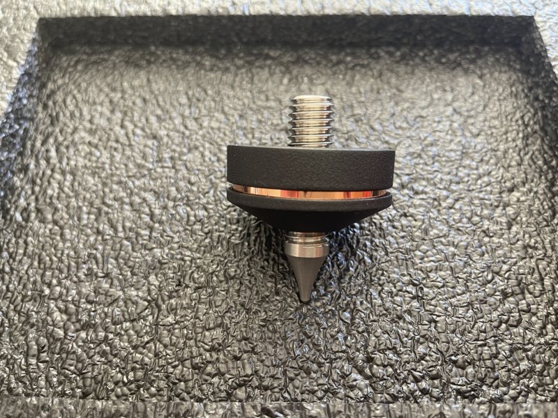

The nice folks at IsoAcoustics reported that the S5Mkii feet are ½”-13 thread size.

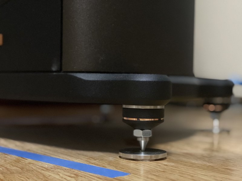

How did the SPods work for you?
One of my clients started with the standard S3 MkII spiked feet on his hardwood floor, and then upgraded to the SPODs. One important thing was to make sure the nuts were screwed on tight, using a wrench and not just loose or just loosely tightened. Once properly installed, the bass extended lower and was tighter with greater clarity. The midrange also improved. The difference was pretty immediately noticeable.
