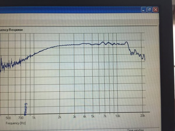

In response to the OP:
Back in the spring I opted to buy a pair of used pro cinema speakers intended for active configuration, the Electro-Voice TS940D-LX, simply out of curiosity and being in particular that they sport the EV DH1A compression driver. It's a beast of a driver (that was developed in '86) mounted to the HP940 Constant Directivity horn (Don Keele design), and we've crossed it just below 800Hz (789Hz, if I remember correctly) with the Xilica XP3060 digital cross-over, 36dB/octave L/R. From here it goes up rather smoothly to about 14kHz where it starts to roll off (see pic).
So, a 2-way design with two parallel coupled 15" drivers beneath it, and some would ask: why not a 3-way main speaker with a "super tweeter" on top from, say, 10kHz? You sense a bit of air lacking in the very upper extremes with select musical material (it's a 2" exit unit with the adapter, one must add, with a 3" voice coil), but to be honest I cherish the simplicity and the perceived more full-range driver sound it lends to itself; to my ears you cannot avoid hearing extra cross-over points having some impact, even very high in frequency, and I favor cohesion over extension. Choices, and compromises (my system is 3-way; tapped horn subs take over from 83Hz on down).
Why the DH1A? Admittedly I only read about it, but what I read drew an interesting picture of a driver of awesome power in addition to excellent sonic capabilities - even at low volumes (all of which I can readily confirm). Pro drivers, some say, aren't always adept at delivering nuance and subtleties in their presentation, let alone at lower volumes (many seem to require some "juice" to truly come alive), but the DH1A combines hifi-sensibilities with massive SPL delivery. A sledge hammer wrapped in satin, if you would.
And indeed, the DH1A delivers: coupled actively it sports a lovely and unforced presence, very authentic physicality and tone, and it's extremely resolved - not to mention insanely dynamic. If anything the HP940 may be the sonic bottleneck, even though it's enormously satisfying as is, and for best results the DH1A may see a better partner in the bigger HP9040 horn to truly harness the sheer energy produced by this driver. For now though I'm very happy with the sonic results of my system. In essence it's monitor set-up, but no less musical for being so - to my ears.
EDIT: supplied frequency curve of the DH1A through the HP940 horn only has 3 very small notches past 14kHz, and a slight peak damping at approx. 13.2kHz.

Nice story, thx! I too have decided I like a two-way for coherence.
Thanks :) And yes, there is something beguiling about fewer cross-over points, but where I wouldn't want to be without a 3-way set-up is crossing over to a pair (or more) of subs hereby relieving the 2-way mains from the midbass and down, preferably crossed no lower than 80Hz (meaning: the mains will need to be high-passed, and so not to add a digital XO on top of a passive filter my advice would be to go fully active with the mains as well). High-passing the mains fairly high is all about achieving proper energy coherence in the presentation for a more authentic, live feel, and active configuration only adds to this quality vs. a passive filter - to my ears.
Since you are using a digital crossover, did you try boosting the top octave a bit to get a bit more air and openness?
Yes, that's what named 3 notches was about to achieve, but we wound up using less dB-correction to instead go for a more natural character in the last audible octave (erasing a slightly can-ey imprinting here that made strings in particular sound less convincing), using more energy to find out where to be place the notches, at the price of ultimate extension. Trying to compensate more heavily (i.e.: with more dB's) for the roll-off resulted in an overall less natural presentation in the upper octaves.
