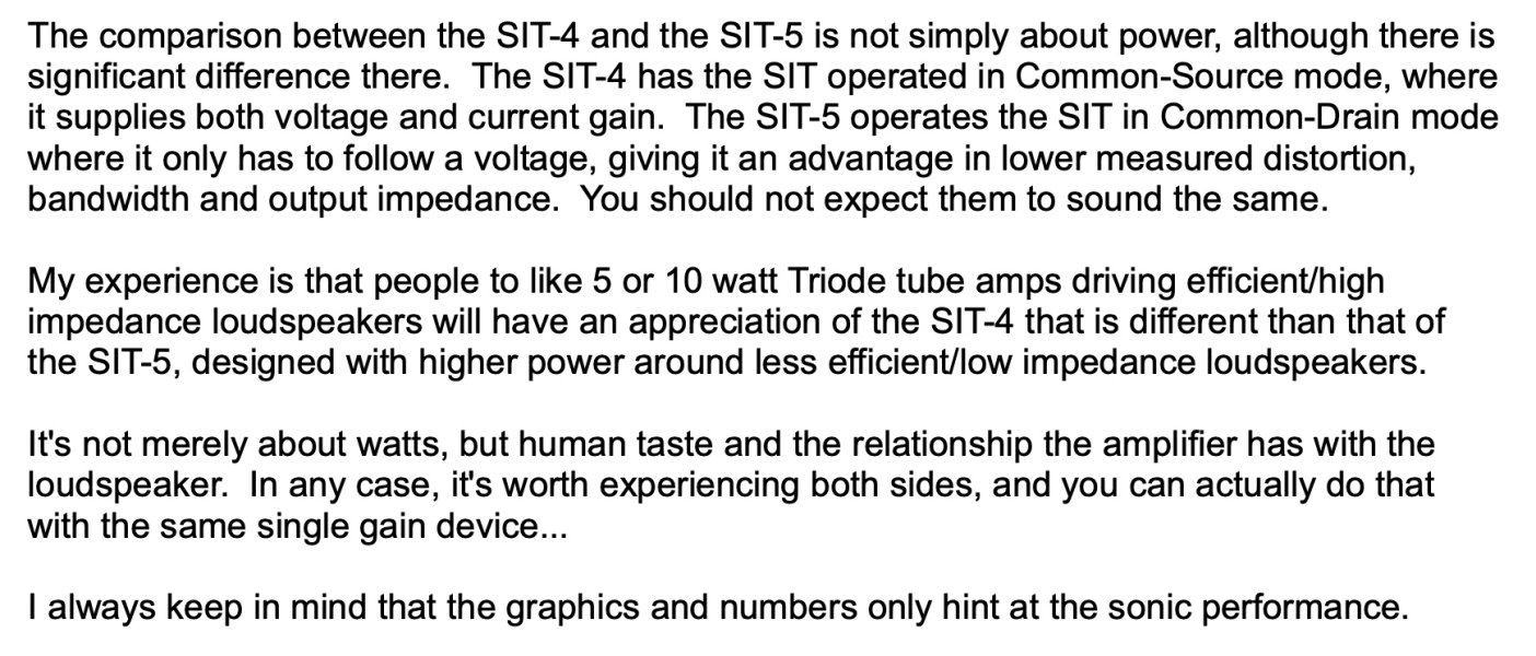

While the SIT5 has a lot more power than the other FW amps I haven't compared the SIT5 and XA25 directly as they are in two different locations/systems. To be safe I suggest you contact Pass who will probably give clear guidance to your concerns.

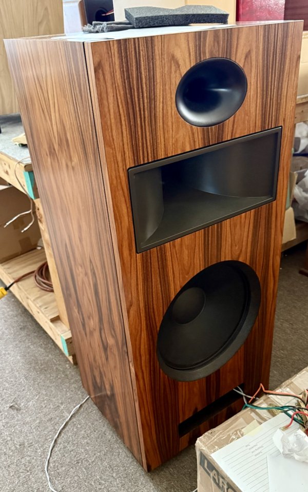

The reason is - a pair of speakers I picked up last week. Clearwave Loudspeaker Symphonia 1. Not many made, not well known... but top shelf Accuton Tweet / Mid, and SS Illuminator woofer. Enclosure built extremely well. Mundorf / Cardas parts. All great stuff. 4 ohm speakers, 86db... certainly not the easiest load, but SIT-3 is a "4-8 ohm amp" (that's what the numbers say!) and we've read about needing a resistor for 16ohm, etc. SIT-3 Power increases into 4ohm from 8, so we should be "OK", right?
So, I hook the Clearwave speakers up to my new most favoritest amp, SIT-3, and the speakers were... HORRIBLE. UNLISTENABLE. I play with speakers, and it sounded like too small airspace... humped up, bloaty, ugly mid-bass boom. I even pulled the ports from the speaker, played with a 4" OD port tube on the OUTSIDE of the enclosure to "increase airspace" (it actually helped)... but the speaker still sucked. That's the only way to put it, other than "Horrible" too. It Sucked Horribly.
But wait... Next week, I am heading to GR in Texas to help get my Line Arrays squared away. I figure it's also a great time to hear the SIT-3 on a pair of 95db, 7' tall, open baffle NX-Treme speakers. I've heard Danny's speakers with his stuff before (laid back), now I have shipped some of my stuff... KX-5 Twenty, QX-5 Twenty, SIT-3.
So, with no amp for the Clearwave... well I hook up the XA30.8 and... BINGO! HOLY COW!
The speakers came alive. The bass tightened right up. I still stuffed the port to help tighten a bit more and blended to Rythmik servo subs.
The Clearwave speakers needed an amp with CURRENT to boss those drivers around... the SIT-3 is just a bit too "friendly", but the friendliness of the SIT-3 is where the magic is, and that amp is good enough to build a speaker around, IMO.
Now, the Clearwave Loudspeaker Symphonia 1 are awesome... I want more Accuton, etc. Happy, Happy, Happy.
The thing is... the speakers were already awesome, but the SIT-3 to Speaker pairing was a horrible mismatch:
Even though, on paper, the SIT-3 should have been OK
What is interesting, my Wilson Audio Duette are great with the SIT-3. Also 4ohm, but more efficient and I suspect are just a much easier load than the Symphonia - overall. In fact, I own a Clio Pocket measuring setup, I am going to measure the Symphonia to get a better idea of what is going on - response and loading.

Well, unfortunately the SIT-3 could not handle the GR-Research NX-Treme. They need more current.
Too bad I didn't have a pair of SIT-5 "handy", but I have interacted with "key people" and the experience is likely to be similar with SIT-5. That's part of the challenge... it's hard to cross fingers at that $ number to "test".
I assume what I experienced with SIT-3 is going to be somewhat relevant for SIT-5 speaker pairing, which is also part of the challenge because it has also been my experience that "definitive" Yes / No... will / won't work is tougher to come by with the First Watt stuff. I understand why after playing with the SIT-3 on various speakers now. The good stuff doesn't necessarily come easy and "knowing for sure" with several of these amps may mean you just have to Listen.
So, no SIT-5 for me for now, but I am certain they are wonderful with the right pairing. Perhaps I need to listen to Kent and try the XA25.

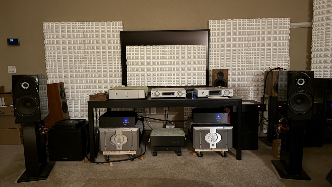

My room in progress... getting ready to lower the table, put SIT-5 on top shelf, and finish off treatments properly.
I AM HAVING FUN.

Now I’ve been going back and forth endlessly between the xa-25, Sit-4 and Sit-5. I was going xa-25 but the neutrality is a concern. What I’ve discovered moving “up” in audio is that I don’t like listening to a lot of my old 70’s bad recordings as much anymore. Not sure the xa-25 is going to help that. Perhaps make that worse?
Now both the 4 and 5 seem very appealing. My amp now is 9 watts or 18 in parallel. I fear the Sit-4 will be too similar in control and oomph. I fear the Sit-5 may be too much power for the Volti Lucera at 99db, probably really 97db.

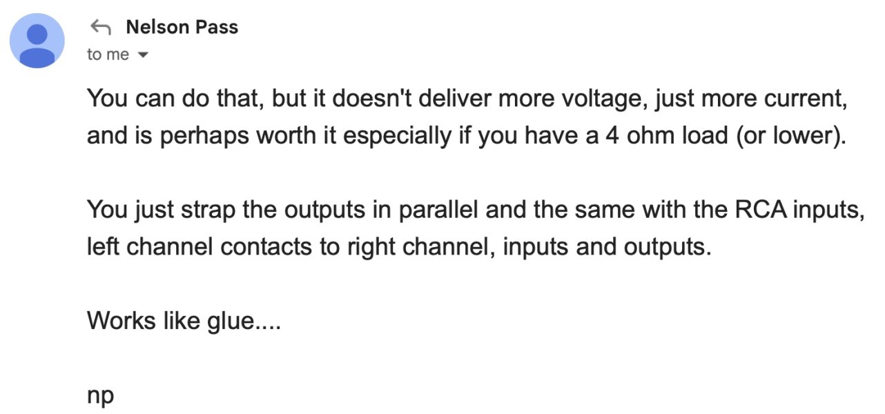

Could 2 be used as mono
The SIT 3 should be an amp that you look at as it has the most enchanting sound. It worked extremely well with my PBN 2!5 speakers that had dual 15" woofers.
Could 2 be used as mono blocks? I ask because somewhere in this thread someone said the Sit-3 wasn’t very good at pushing their 96db, 8 ohm speakers very well, which is almost the exact figures of my speakers. Please don’t quote me since my memory isn’t as reliable as it used to be. Lol
If you look at the speakers above, the issue was with large, multi-driver speakers. We figured, even though the speaker specs show it as easy to drive, putting a bunch of drivers together mean they are going to need some current.
So, I asked Nelson about the passage in the SIT-3 manual (read the FW manuals, for sure) where he mentions paralleling 2 channels for more current, and I asked him to confirm that.
Yep... you can turn the SIT-3 into monoblocks.

Now, my problem is somewhat different and I'd really appreciate any input. My AvantGarde Omega Duo speakers are something like 107dB efficiency and I understand the impedance is 16 Ohms. I've been running them for years with Audion parallel single ended 300b monoblocks.
Recently I tried my Passlabs XA30.5 in the system instead of the Audions and I've been amazed that I prefer the Passlabs - warmer, richer mids and huge soundstage as well as being smoother and more forgiving with less then audiophile recording but giving nothing away in terms of frequency extension, dynamics etc. In fact the XA30.5 sound more like a valve amp than I would've ever expected.
Because monoblocks work better physically with my system configuration, I decide to look at options, including the SIT-5. In another system I have an old Sony V-fet power amp TA-8550 and appreciate the idea of a modern version of similar type of amplification device. The opinions I've read online suggest FW SIT amps are likely to give significant further improvement over the Passlabs XA30.5
But, the power figures of the SIT-4 suggests it might be a better match with my very efficient, high-impedance speakers. I've found quite convincing reviews that loved the SIT-1 with the AvantGardes.
I can only guess at the power levels of the SIT-4 vs the SIT-5 into 16 Ohm speakers, but perhaps the SIT-5 design brief is to improve performance into lower impedance speakers and the power improvement might not be there with my 16 Ohm speakers? I could be paying twice as much for less performance just to get monoblocks?
Unfortunately my location precludes trying before buying - hence I'm keen to do as much homework as possible and seek others' knowledgeable opinions before committing.
Any information/advice gratefully received.
If you read the Stereophile review of the SIT-3, you'll see the reviewer had an issue with it running his 16ohm speakers. That was not a surprise to Nelson. A pair of resistors on the speakers put them at a load the SIT-3 liked much better, and the reviewer loved the amp.
I mention that because it would definitely be a good idea to reach out to Kent at Pass, and maybe even Nelson... ask about the 16ohm thing.
Also, if you read the manuals for the SIT-4 and SIT-5, you'll find commentary like this (from SIT-5 manual):
Morning gentlemen. I’d like to start by saying that I’ve been using this site for years as a valuable source of information. Many here are very knowledgeable and have quite impressive systems. A bit intimidating actually!
A quick history about my journey. Had the same solid state system for 23 years, Rotel and B&w speakers. With the encouragement of a friend, I decided to go the tube route and change my entire system. Did a push pull Synthesis amp with Zu speakers. For he first time experienced ear fatigue. Frustrated, I sold them both. Purchased the Aric Audio 300b and Audio Note e/lx speakers. Wasn’t completely satisfied with the sound. A lot I liked but I want to be thrilled I guess. Just sold the speakers and purchased much more efficient Volti’s, which really do address the things I wanted, more dynamic, balanced from top to bottom and the amp doesn’t struggle to push them. Effortless sound I suppose.
All this brings me here now. I love the 300b but since I’m sort of a newbie to this endeavor, I’m not sure what I’m missing or left out there sound wise. What I’m looking for, which I had with my ss Rotel and Synthesis push pull, is that oomph and authority. I feel as if the bass gets a little loose at higher volumes with the 300b. The Volti’s have a 15 inch woofer. I like the tube sound, but like other aspects of the solid state sound. Which brought me to Pass and first watt.
Any suggestions or advice would be greatly appreciated. Thank you in advance guys.
This may help you:
Kent English at Pass, who will probably answer the phone when you call, uses an XA25 at home. His wife is a musician and he says she says that one sounds the best. You should talk to him about the XA25.
