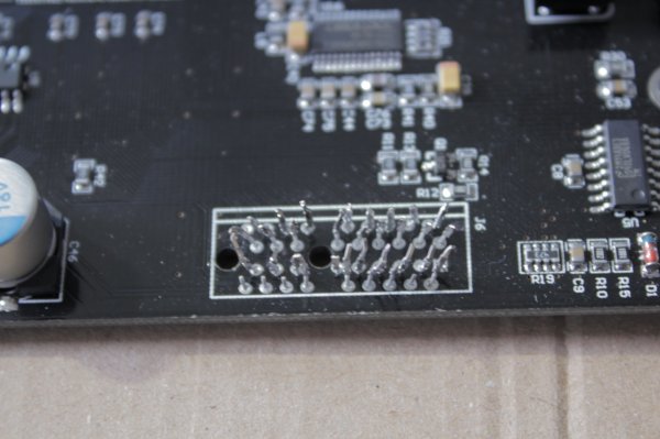

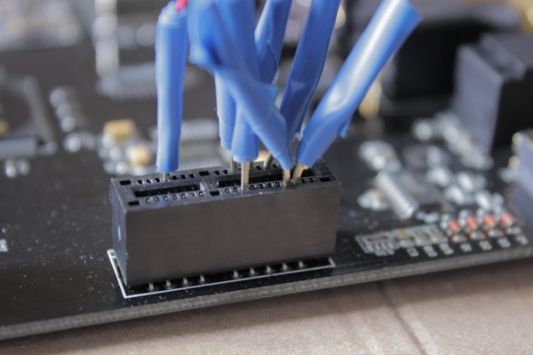

Anyway, I've been thinking about how best to hardwire the WaveIO to the X20.
Lucian, who produces the WaveIO, made a good suggestion, saying that to keep
things nice and simple. Just solder the relevant wires to the underside pin
bases on the PCIe socket.
I took the digital board out to take a look, and though it is a bit fiddly, if you're
proficient enough to solder the coax cable in, this should pose no real problem.
However, looking at wire routing and board placements, in the end I 'bit the
bullet' so to speak, and chopped the PCIe socket off. I did this by nibbling
away at it with some small wire cutters (top down) until just the base wiring
was left intact. I was careful not to actually touch the PCB at any point, so
there was no risk to the traces. My back-up being that if all went wrong I
could still wire up to the bottom pin out points. That was yesterday night,
today I am going to (attempt to) wire the WaveIO in.
( all pins pre-tested and mapped in advance of course )
I'm not touching the HDMI side of things at all, as that is my back-up input.
However, the future of the other inputs looks bleak, as I want to place the
WaveIO in that area. I simply don't see me ever using the bnc/coax/xlr
inputs at all. So, I think they're going to go, as I'd like a flatter area
to work with here.

Just a quick update on my PCIe endeavours.
If I was doing this again would I remove the PCIe slot, NO. I simply don't
hear any benefit between wiring direct to the PCB or using the easy, pins into the PCIe
method. However you WILL save yourself many many hours of hassle, and lots of swearing
by sticking to using pins, or possibly wiring to the base of the relevant pins under
the PCIe slot. Or, if you are tempted, wire to the original pin stubs once you cut off
the slot, going through hole proved to be a real pain ...
My soldering skills are ok-ish. However, what looks like a difficult, but do-able job starts
to get serious once you start installation. Those hook up wires are only just over an inch long.
On the advice of Lucian, who produces the WaveIO, I added a ground wire for each of the three main
transmission wires. So there are 9 wires in total. That's a lot of wiring in a very small space,
that gets crowded real quick. It was a pig of a job, and hours of squinting, even using a magnifier,
left me with a serious headache. Lol ...
If you're really hot at soldering and have better kit than me, it's probably not a problem.
However, if you're the average level DIY'er like me, the pain is just not worth the gain and
associated risk.
Oh well, just the coax mod to go now, but I will be leaving that for a week or two, when the
migraine this job left me with has gone ... Lol
Mind you, the X20 could do with some burn in hours really. The extra WA Quantum chips are coming
for the capacitors in a day or two. I'll put those on and then just let things settle in for a
good week.
Now lets see if I can add some photos?
Cheers
Simon
There should be 4 pictures. (all rough untidy test work)
One showing the pins into PEIe slot (with insulation tape pulled up a bit to show entry)
One showing the back of the PCIe slot (recommended for an easy hard wired solution)
One showing the removed PCIe slot area. (with pin bases still sticking up)
One showing WaveIO installed. I shall probably neaten the wiring etc, and maybe think about
a screening solution at some point in the near future.
