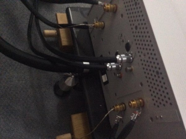

Attention to the owners of Constellation amplifiers. I thought of connecting the nagative terminals to two Silver Minimus boxes. I wrote to Constellation and was told that due to the "Balanced Bridget design" of its amplifiers, damage would occur.
I am struggling to understand by what mechanism damage might occur. Not saying they are incorrect of course, just that I have difficulty comprehending the rational behind it.

This is the mail that Irv Gross sent me, after consulting the technical department:
Hello Francisco,
Our technical department replied:
On our amplifiers the (-) binding post is not at GROUND potential, it sits at a negative voltage below ground by the same amount as the (+) phase output sits positive above ground. Only the CHASSIS of the amplifier is GROUND. The left and right (-) posts are NOT to be connected to each other or to ground or the chassis EVER. Just like you would not attach the left and right (+) posts to each other or ground, do not do it to the (-). Doing anything like this to any of the outputs SHORTS the amplifier out and can DAMAGE it.
Best regards,
Irv

Most probably people from Constellation Audio do not know what the Silver Minimus boxes really are. As soon as they read "ground" they think about a low resistance connection and immediately tell users "DON'T DO IT"!
If you are using two separated isolated boxes, each connected to its negative post, you will not have problems.
Oh, I consult with Sven from Entreq, and he thinks there will be no problem.
I also think, maybe in Constellation, confuse the devices like Entreq Silver with others like the Troy, that they do connect to power,
but .............. who risks " Fry "your amplifier?
Yep! "ground" to any good engineer always means 'common reference point' and often a specific reference. Grounds always have two or more connections (can't be common without at least two).
As stated in a previous post, I have the Centaur amplifier with two Silver Minimus' hooked to Neg. L&R channel. NO ISSUE. I am listening as I write this. :confused: :eek:

Yes, Constellation amplifiers are balanced type. Usually one of the main scope to use balanced based projects is to eliminate noise coming from chassis ground.
but there are not active components into Entreq ground boxes, so I do not find any issues to use groundboxes on balanced type of amplifiers.
Maybe could be a contradiction to add something that can add a potential noise to a balanced amplifier, which is completely disconnected to chassis ground throughout all the signal path.
