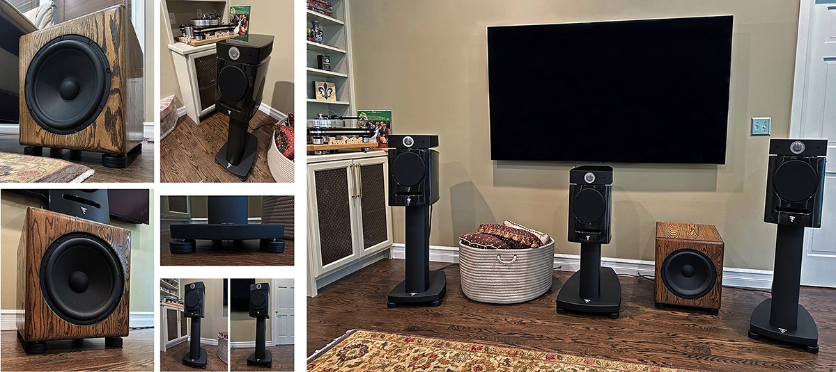

With a center channel stand coming, I need to decide on one of two possible locations for the sub I have been using as a center channel stand. I will likely just move it over to the right between the center channel and the front right main. The other option is to place it next to the couch. The other subwoofer will stay in the corner next to the couch in any scenario. The subs do work nicely as an end table and I wouldn't mind lifting them up a little. Currently I use 4 ea. Herbie's Fat Dots under each sub.

I am making some changes to my Family Room and considering these options for subwoofer placement. 2-channel is my priority and I've been using a subwoofer as a center channel stand and it has been fine. I've just replaced 3 ea. Dynaudio Contour 20's with 3 ea. Focal Diablo Utopia Colour EVO's. The FL/FR Diablo's used as mains are on Diablo Stands. I've just ordered a Focal Viva Utopia stand I plan on modifying to use as a center channel stand for the 3rd Diablo I use as a Center Channel. It is the perfect height with similar if not identical cosmetics. Focal mentions I may have to drill new holes since the Viva and Diablo stand mount screw holes are slightly different.
I use StackAudio Auva 70 feet on all three stands. Not so much to change the sound or performance of the diablos but because I move them out into the room for critical listening for small groups and up against the wall to get them out of the way when hosting a larger group. The felt on the bottom of the feet make moving them easy, adds width and stability, and put the FL/FR tweeters at the right height. I don't have the Viva stand yet but hope I can adjust the Auva 70 feet to tilt the CC up just a bit.

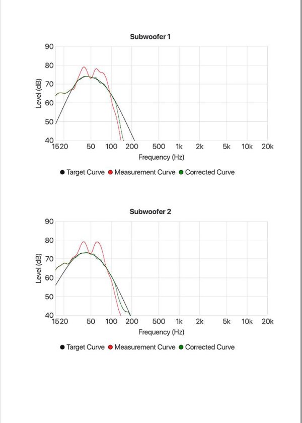

These were the STR Anthem Room Correction results with the Contour 20"s and the sub locations shown in above pictures. Of course the CC is not active when using the Anthem STR.

Your subwoofers waveforms appear alarmingly spiky and rolled off. Possibly may very well be your rooms bass sucking null locations.

I installed StackAudio Auva 70's on the subwoofers and speakers. They make it easy to move the speakers for cleaning or pushing closer to the wall when a large group is over.

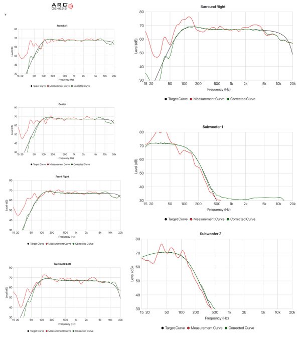

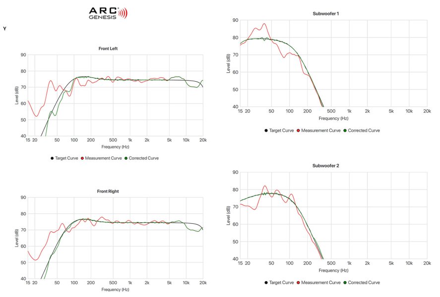

I finally ran ARC Genesis on the STR and an Anthem AVM 90 for when the STR is in Home Theater Bypass mode. I have pushed the limits of placement options since decor is my wife's passionate hobby. With our challenging space the systems still sound amazing. Thanks.
