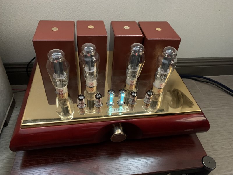

After many iterations, the best amplifier I’ve found for my 2905s is a JJ 323 SET — a 90 pound beast of an amplifier that uses a parallel pair of 300B tubes per channel to deliver about 15-20 watts. The sound is beautiful — the 2905s can sound a bit clinical when driven by most solid state amplifiers.
