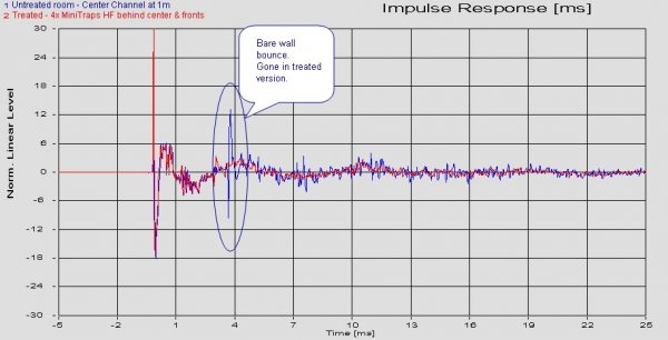

Just to provide one simple example of how a room treatment effect is clearly visible in a measurement, here is an impulse response of a speaker placed close to wall, then treating said wall with broad-band absorption:
It totally kills that nasty spike and cleans up some of the comb filtering (visible in the Bode plot in the threads I linked to).
