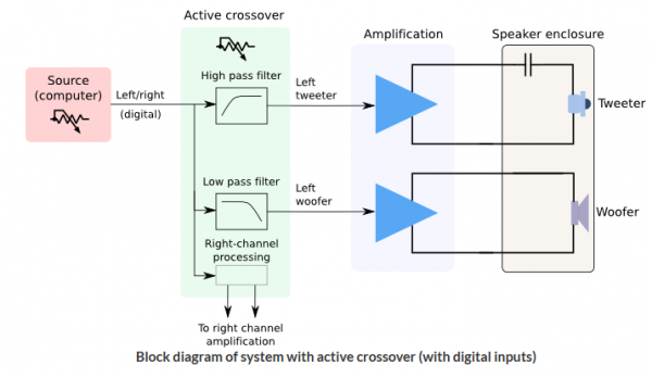

I'm looking to learn a bit more about digital active crossovers. For instance between direct radiating midbass/mid driver and a wave guide compression driver. What is the advantage to them over for instance a Marchand active solid state crossover?

The advantage of a digital crossover in this specific instance is that you can choose the crossover slopes. More importantly in the case of mating a compression driver to a direct radiating driver it allows you to select and use asymmetrical slope settings. The horn can drop of steeply but you can bring the bass driver in more gently effectively getting a smoother transition. With a unit like the Marchand Xs you get 24 or 48dB slopes and pretty much have to live with that. Asymmetry can be advantageous in cases of particular driver physical arrangements on the baffle as well as some other factors.

Where there are individual crossover slopes, time and phase alignment at each crossover point instead of an overall 20-20k EQ.

The multiple analog outputs is because the system will be multi amped

So I need either a multi-channel preamp or some other way to split the signal.

Further down the road I do not want to do D to A (AN 4.1) -> Minidsp performing A to D -> {DSP processing for xover} -> D to A -> amplifier. I've discussed my setup with Uli at Acourate about using a pro multiple digital output soundcard to a multichannel DAC (or four individual stereo DACs) that way I only have a single D to A conversion occurring.
That's one way to do it, but better and cheaper just to use an Exasound (which is a multi-channel USB DAC) unless you can throw a lot of money at it.
