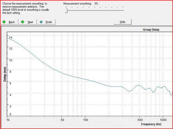

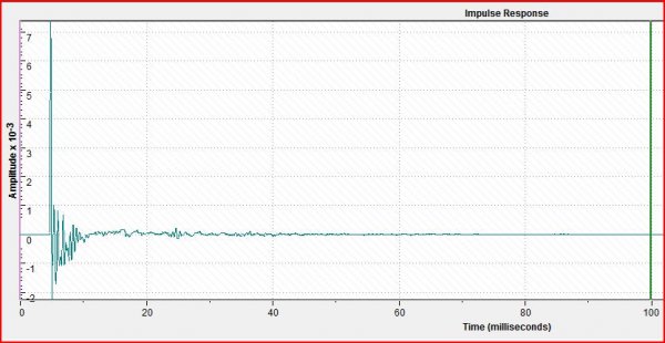

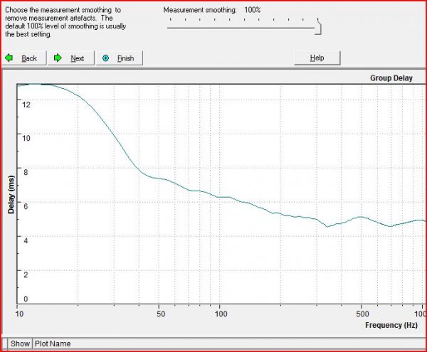

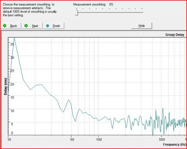

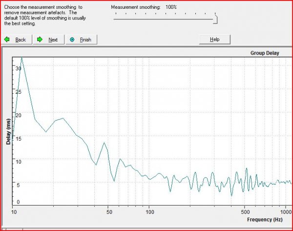

I took some screen shots of a close mic'd measurement I did of my current 15" woofer, and my primary goal is to adjust group delay rather than frequency response
The first 2 graphs are with the window truncated right back to the finish of the main energy pulse (ie around 8ms).
100% smoothing
no smoothing
tuncation out to 100ms
100% smoothing
no smoothing
