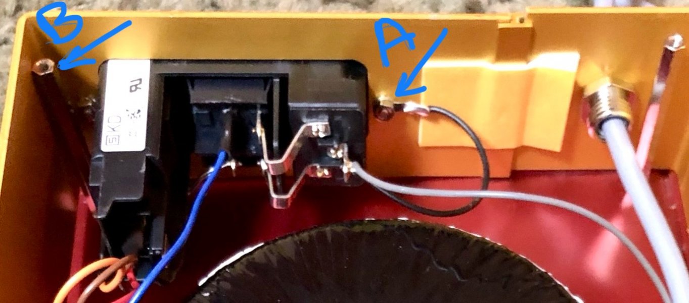

I measured ~0.1ohm resistance using this screw.
Probably better; but doubt it will make a difference, to use the circled screw pictured below instead, but note that it’s very short, so you will need a longer screw, and you’ll need to secure the nut from the inside while you tighten It. Note that it’s connected to the chassis/case, and I used the post you see to the left of the AC connector.
The reason why the ground makes a difference on the preamp is because the signal/chassis ground is still connected to the AC mains ground, even though it’s battery powered. This is must be why @Mike Lavigne noticed that the AC cord makes a difference on the 18NS. Note that you can set the ground lift to on, which may make this unnecessary; but I haven’t changed it (My ground jumper is “Connected” inside the preamp).

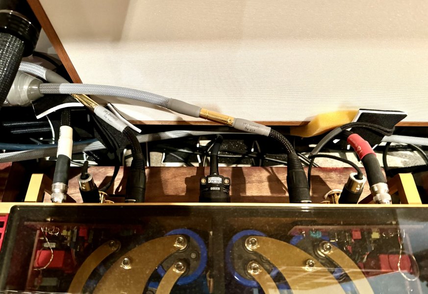

Will post a photo of the back of the amp shortly.

Ha ha, yes — I saw post #58, but I wasn’t 100% clear on which screw was shown. Too zoomed in :)
The internal pic you just posted circles the screw where I got the lowest measurement, which is encouraging. Whether or not the screw choice makes a difference here is another thing entirely, of course.

I used the screw on top of the case, in the upper left corner - you can see the screw post in the image above. It’s the closest top cover screw to the AC inlet.

Hi Zeotrope, Just passin' through and reading this thread out of idle curiosity (hi Ben!) and saw your pictures of the ALTAIRA installed on your 18NS/108. Although I understand the cable shoes are attached to bolts that go into or through the chassis plates the cable shoe itself is not making galvanic contact with the case because of the anodising. Anodising is actually a very good insulator! Best practice is to Dremel away the anodising under the shoe for chassis earthing wires (my apologies if you have done this but it doesn't look like it). Of course that may influence your choice of which screw to use!
Hi! Thanks for your message.
Actually, DarTZeel uses the 18NS power supply case as a ground point. You can see this in the interior photo of the PSU. So the case screw is perfectly fine. Again, resistance was measured to be < 0.1 ohm. Appreciate the comment though, never hurts to check!

Sounds like it's all good. I was just going on what I could see in the photos which don't reveal what is going on under that screw head. Is it going into a tapped hole with good contact with bare metal all the way through or is it going through a drilled hole to a nut on the other (anodised) side? If the latter it could conceivably be making no galvanic contact, I guess you are saying it is the former. What is the resistance measurement you refer to? Between which points? Cable shoe and ???
Hi, I actually just measured resistance again, between A and B (i.e., the screws that are threaded into both points), and it’s 0.9 ohm.
Shunyata says resistance should be <1 ohm for a good ground connection, so I think it’s fine.
In my notes when I installed it I measured 0.1ohm between the actual AC ground plug receptacle and the screw post (maybe I made a mistake, but I doubt it ;).

Well It definitely sounds like my concerns were unfounded although I still don't understand from looking at the photos how/where the galvanic contact is being made. All I can see is anodised surfaces! Anyway, thanks for answering, I was just curious.
I'm not 100% sure either, but the ohm meter doesn't lie! Thanks for your interest and curiosity, I appreciate it!
