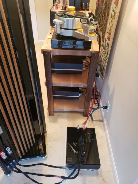

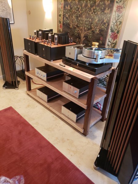

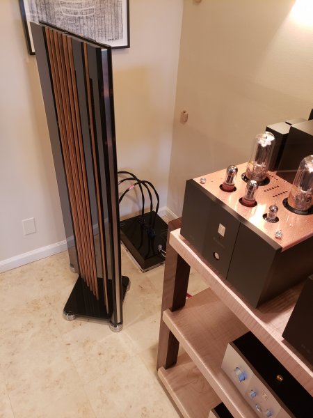

Installed external Xovers on a customer's Tintorettos today. Now they are Tintoretto X's.

Great photos! Did the owner put the Alsyvox's on Stillpoints Ultra 5s? I see that Alsyvox's normally come with their own black, round, thick footers. Presume those are by the manufacturer (not Stillpoints). If this is correct, any thoughts on the change to Stillpoints?
All Alsyvox come now with silver cups/balls as the footers standard. They used to be black.
I have Ultra 5's on my Botticelli X's as they make it easier for me to move them around vs. with the balls/cups.
Sonically the Ultra 5's clean up the sound a bit, more transparent, a bit more clear, with a bit less full bodied bass. It's a personal preference type thing and has a LOT to do with what the speakers are sitting on, ie, light carpet, thick carpet, wood etc.
If one wants the flexibility to move the speakers around the Ultra 5s work really well vs. the balls/cups.
Good to know. Thanks.
View attachment 66758 View attachment 66759 View attachment 66760
What is the value add of having 2 external passive crossovers? How are these crossovers different than what is in the standard model? Why is there such a cost difference?
What does one gain sonically with external passive crossovers?
If one orders a standard model initially, is there flexibility to upgrade to the external passive crossovers later?
>>>>The Xovers take any of the Alsyvox to a different sonic level. They sound great without the external Xovers, but it's like night and day when you insert the external Xovers. MORE of everything. Better separation of instruments (transparency) better midrange, better bass, etc.
The circuit of the Xover is similar to the internal Xovers but the parts are all Mundorf and are large components and laid out differently.
When you pick one you realize that they are basically like buying a high level preamp. $15K each once you see what they do to the speaker seems VERY reasonable.
>>>>Answered above. EVERYTHING the speaker does with internal Xover is heightened in performance with the addition of the external Xover.
>>>Many people do this. There is an external switch on all the models. You just flip the switch to use either the internal or external Xovers.

An interesting discovery was how large of a difference grounding the external crossovers make, it's kind of huge. Daniele supplies shorting plugs which connects the aluminium crossover boxes to the amplifier ground (speaker cable -), the effect of that is borderline shocking. Need to explore that further.
