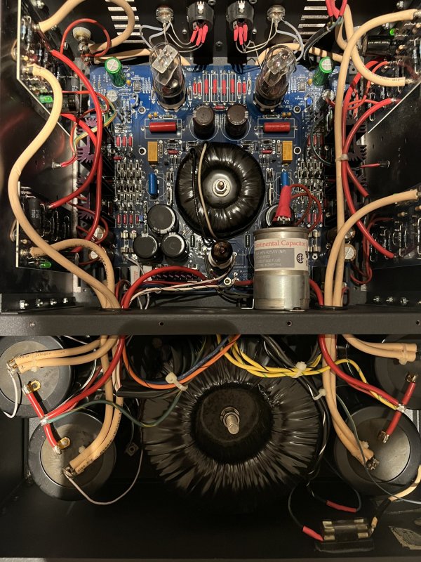

Recently got 2 parts amps in their respective sorry state SA220 and NP220.
The NP220 required pretty much a total rebuild. After hours and hours replacing broken parts, putting in missing parts, and repairing broken traces it's happily singing again!

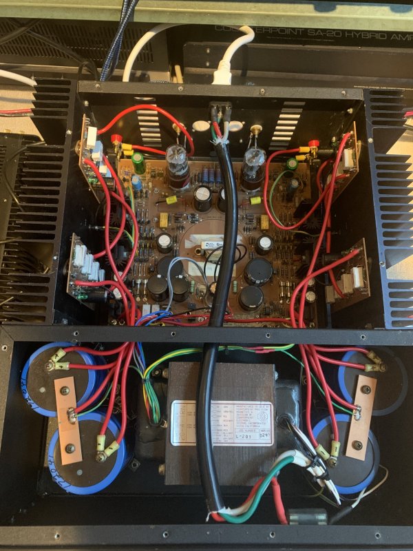

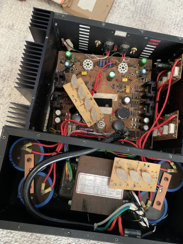

Seems like there are more NP220s in the used market recently. Most of them badly molested by “techs” who think they know what they’re doing and end up blowing every fuse every transistor and frying traces on the motherboard. Here’s an example of one that a friend bought as parts and landed on my bench for rework. I just say servicing these without lifting the motherboard is like nano surgery. All’s good now.

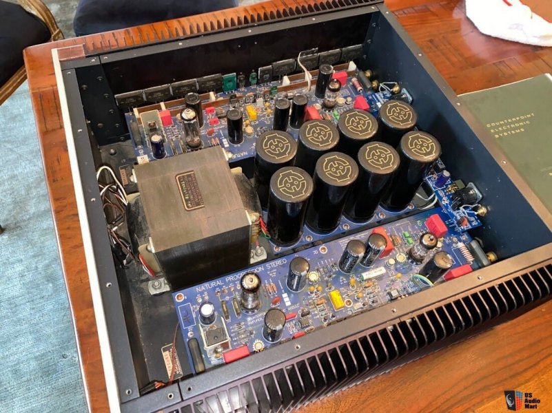

How do I know what level of work was done to my NPS 400?
This original owner indicated this was one of a "last batch" from Counterpoint 1996 .. although I see designations of "NPS 400 a" etc ..
It does have the square transformer in it .. I have upgraded both sets of tubes from the Michigan tube guy and a new set of HiFi Tuning fuses .. all made a nice improvement (the BIG improvement came w/ a pair of Dale Pitcher (r.i.p.) balanced Input cables and a combo his Basic speaker wires in bi-wire!)
a means North America that’s it
If it has a few round transistors right next to the 6922 then it’s stick
if those are removed and you see some black Mills MRA12 27knor 33k resistors that’s upgraded.
i have serviced over 10 NPS series and owned and still own 2 NpS400 and 2 nps200 and I’ve never seen 2 Alta vista units identical.
