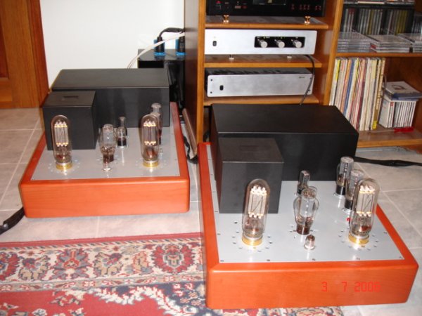

It's been almost 2 years since i sold my diy 845 PSE ( 2 * 845 parallel SE) monoblocks. I was a lucky bastard to have 4 nos RCA 845.
The schematic i implemented was the famous Ancoru except the input tube. I used the 5842, rc coupled to 300B, IT coupled to 845. All irons including chokes were 2C core and finally the OPT were Bartolucci, enormous irons.
Give me a email to send some photos and meauserents.
Regards,
George
..Sorry Keith, amp sold complete with tubes. It took me almost a year to collect all parts and six months to finish it. They cost me around 5500 euros and sold it to a friend the same price ....
my 845 PSE
Freq. resp. : 13HZ - 45KHZ, (1khz, -3db) at 72 Watts
Va 845 : 1110 Volts, Ia = 75 - 78 mA
THD : 0.5% --> 25 Watts
0.8% --> 40 Watts
2.5% --> 50 Watts
3.7% --> 64 Watts
5.8% --> 72 Watts
