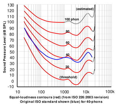

In power, 10 dB is 10x the power, 20 dB is 100x, 30 dB is 100x, and so forth. At 80 dB SPL, about ten times the power (10 dB) is needed for a 100 Hz tone to sound as loud as 1 kHz. It rises to ~100x at 50 Hz, and almost 40 dB (10,000x) at 20 Hz. In practice you probably do not really want the deep bass as loud as the midrange, but generally it takes much more power to produce pleasing deep bass loud enough for us to appreciate.
