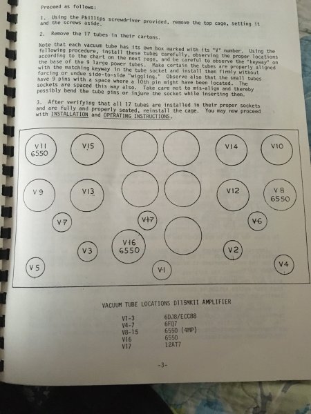

Thanks for your response. I have not tried what you suggested as my tech said the tubes were good. However, I will. The warble does happen on both channels. Excuse my ignorance, but do you happen to know which are the tube positions V-? in the stabalized power supply for driver and input I should swap out?

According to the schematic V16 and V17 - one 6550 and the 12AT7 . I would try exchanging them. I now remember that the input inverter V1 is also shared - next I would try it.
We can find the complete schematics here http://4tubes.com/SCHEMATICS/BY-BRAND/Audio-research/

I've swapped out V16, V17 and V1 . The problem persists. When I turn the amp on having been off for may hours, the noise is more pronounced. If the amp has been on and warmed up and I then turn it off and on, the noise is much less pronounced. Does it sound like it might be a loose solder joint?
I would not expect a loose solder joint to modify its behavior systematically after such short time - it takes a longer time to raise the temperature.
The D115 has five different power supply sections, it will not be easy to diagnose just from the symptoms. I would however try all new tubes before taking any action - I have seen cases where we have crosstalk because of excessive current drain by one signal tube.
