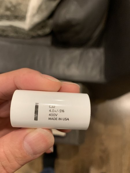

Thank you everyone, especially Larry, for all the help in properly diagnosing the problem. As it’s pertinent to the story, I wanted to settle the Issue with CJ first to be able to provide the full scoop. Jeff at CJ informed me to return the GATV2, he explained the circuit board holes used fas anchor points, are very sharp and in the shipping process, the nylon tie downs must have gotten sliced. And the capacitor being heavy, snapped off as it was only held on by tiny solder points. Regardless I’m insisting on a completely different unit. My dealer Ross came through and agreed to cover shipping cost back to CJ.
My question would a loose capacitor cause the hum? Jeff understandably was noncommittal. See attached photos. Presently I’m continuing to clean up my environment and getting shielded RCA cables (belden 8402 with Duelund plastic free RCA). Also considering a ground loop eliminator.

It depends on where it was being used. If it one of many in parallel in the psu I say it’s not the cause. if it’s 1 in a filter circuit yes. Either way you need to make your system reasonable silent. For one it’s now obvious not to be the lampizator it’s my real concern in this. I also tell buyers lampizator is a large family to help if help is asked for and not a dart board if you get my drift. so who lives near Justin user211 now lol.
What is the point of wondering if the capacitor could be the issue? When you get the unit back you will see if it was or wasn't the cause of the hum.
