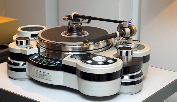

We did swap quite a number of cartridges between the two arms because we needed to demo both cartridges and wanted the best compromise. But with the same cartridge (two of the TechDas TDC01Ti) the SAT was far, far better. The SME sounded like it was distorting. We switched the cartridges between the two to be sure.
When I ran my torture track (HiFi News Analogue Test LP Side 2 track 4 - 300Hz +15dB), I could feel the vibrations in the arm-rest of the SME. Not sure if it's due to the secondary arm board hanging out the back, but tightening the screws as much as we could between the armboard and the body of the turntable didn't help. Not many cartridges can track this track without distortion, but this is the first time I've felt the vibrations go through the arm pillar to the arm-rest platform. We weren't sure where the problem came from, but the arm displayed the same alarming vibrations using the DS Audio cartridge as well.
Gary,
very interesting about the 'vibrations through the arm board' comments for the SME arm.
a few years back I had a number of tt's with cantilevered rotating arm boards and did find that they had 'limitations' and the materials used and 'stoutness' of the attachment had a great effect on the sound. I'm sure that the AF1 has as stout an attachment, and good a material as possible.....but ultimately you end up comparing mounting schemes and not arms when the two mounts are so different.
I wonder whether listening through headphones might have changed the outcome? or maybe with the bass towers turned off or down?......to eliminate the 'feedback from the speakers' factor. for me recently this was the case with my MM7 bass towers so close to the turntable. maybe the AF1 suspension works fine for the right side short arm mount, but has limits to isolate the left side cantilevered mount. "my guess is that" your non musical test track pushed past the design envelope of that left side mount position (and the longer arms can be heavier making the delta worse).....maybe it's ok for most/all music and you just found it's bad place. you would ultimately have to compare various arms from that left side spot to know what the arms are actually doing themselves.
my solution to feedback was to improve the decoupling by substituting a Herzan active platform for the regular passive NVS decoupling platform.
Yes - that's a good point, Mike. Something I wondered myself as we had the titanium armboard on the right side. The right side armboard would not accommodate the 12-inch arm, so exchanging arms wasn't going to work. However, that same left-side armboard accommodates a 12-in Graham, and it was excellent in that position.
When we were checking out the turntable, the system wasn't even playing. Besides - you don't want to be listening to a 300Hz +15dB signal much, if at all.
Gary,
My own experience with the V confirms what you heard. It's distorted & colored specially in the bass region, people often miss it due to lack of a reference and/or the complication and interdependence involved with a high end tt player but in this case with the SAT right there as a reference the V's shortcomings became apparent easy to pick out. Don't know if your V was a current generation with the silver wiring or not but IMO there's an additional layer of distortion introduced with the silver. I have identical tonearms on my AF-1 and I hear no sonic difference between the front and rear locations.
david

Gary,
david
Thanks, David. I thought that there might have been something wrong with that particular arm - worn bearings or something. That arm is the long-time demo at this particular dealer and it was suspect when I first heard it a few years ago. They've had this arm for over 5 years, and I am not familiar enough with SME tonearms to comment whether it was a current generation. Like I said, I had a Graham on the rear location, and it sounded excellent.

Thanks Gary for those comments. From the photo, that looks like the 312S arm, which, according to those who have heard all three, sounds quite different from both the 9" V and 12" V-12. If it has sounded suspect to you before, perhaps the dealer should get a different SME demo arm. My SME dealer told me that SME would not design a cantilevered arm board for their 12" arms, preferring the very solid, thick, and massive boards designed for their 20/12 and 30/12 tables. I have not noticed vibrations reaching my armboard, though the arm is designed so that vibrations are drawn away from the cartridge toward the arm base/board.
I would love to hear the SAT arm someday. I've heard some great things about it. If I were in the market, I would be very curious about a direct comparison between the SAT on an AF2 and a Graham on an AF1. I have a hunch the former would sound better and cost less.
