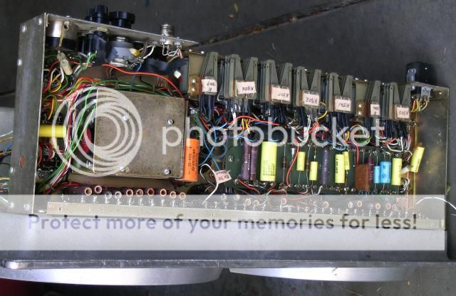

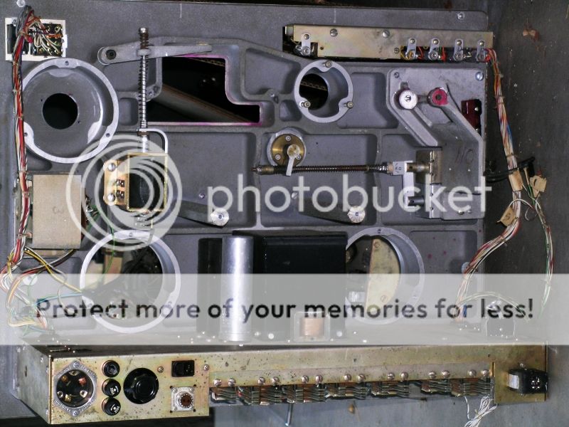

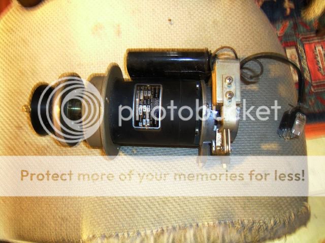

I figured I would start a new thread on this deck because it is so unusual. I ran the numbers on the reel motors and they are special for one inch tape. As you can see all the relays are identified by hand and the mounting bosses are different. The master bias oscilator assembly looks to be common to the MR70,but I will have to look closer. The control board is definitely not a production type. As I get farther a long with this I'll decide how to configure this,maybe 1/2 inch or a one inch 3 track would be a killer machine.

Btw I just got off the phone with the RE I got this from and he said he was given it by one of the project engineers on the MR70. The capstan motor is very large and this transport uses a belt drive system and not the 300 based type flywheel. This type of belt drive was capable of the lowest wow and flutter measurements of any Ampex deck according to the RE. He had it recently assembled and it did pull tape and playback. He very recently dis assembled so I could take it....dang I wish he would have asked me first...but he says I have everything to get it operational. We shall see.
