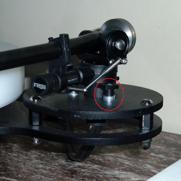

Johnny I never tried Pete's VTA adjuster, and im not sure why it wont work for you but i have used rega arms on mult tables and invariably you'll have to shim your arm - even on a rega 'table/arm combo since rega carts are relatively shorter height-wise compared to just about every other mfr. have you measured the dist from the armboard surface to the top of your platter w/ an LP to get a baseline for adjusting vta? you'll also need to add the height of your cart from the stylus tip to the mounting surface. only then after adjusting VTF can you get a handle if on whether a matt will be additive or subtractive to getting 90-93 degrees SRA.

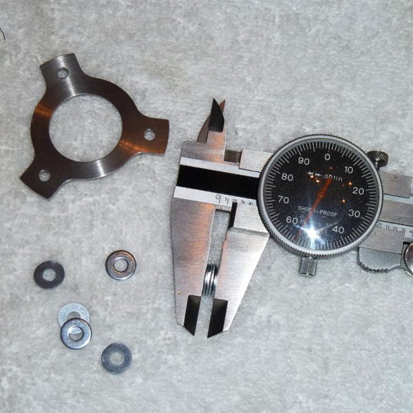

these are pics of some of the shims I used to get in the ballpark for proper VTA, for the OCD 'philes you're not going to adjust VTA on a rega arm for 200g vs 120g with my method, you're going to have to settle for an average and be done with it. the three-eared shim in the upper right hand corner is rega's accessory option thats 2mm thick and is stackable. I also use washers that are for 6/32 machine screws and stack them. these are thinner at about .75mm which makes fine adjustments more precise. a good set of calipers is a must.
