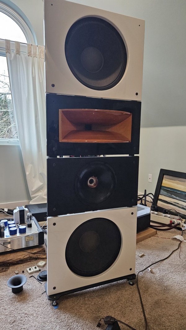

Why isn't this trying to build a partially active system? a tube amp in front of the tweeter horn and 10" Beyma coax driver (please remove the horn funnel). You use the passive crossover 12 dB for horn driver for the 10" Beyma without xover. Then you measure the frequency response of how far the combination plays from the lower limit frequency. then you buy active bass xover then an amp that controls everything 2x 15" + your subwoofer and adapts it to the rest.
I am running such a solution sounds excellent
P.S

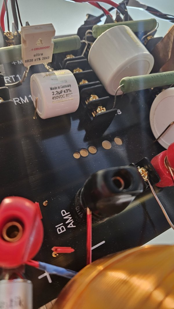

Maybe you have to adjust a resistor in front of the horn driver to get flat response

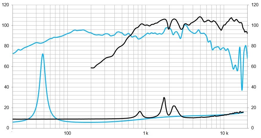

I hold every bet that 10" works down 100-150 hz in your baffle( blue line)beyma-speakers-graph-coaxial-10CX300Fejpg-2-637061.jpg
