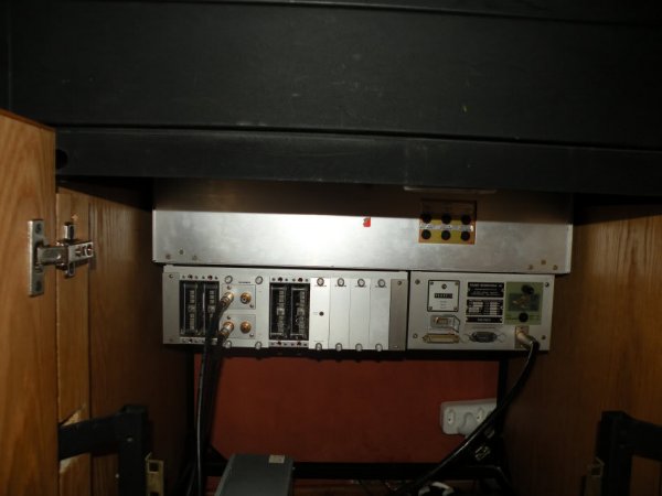

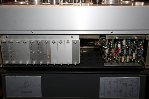

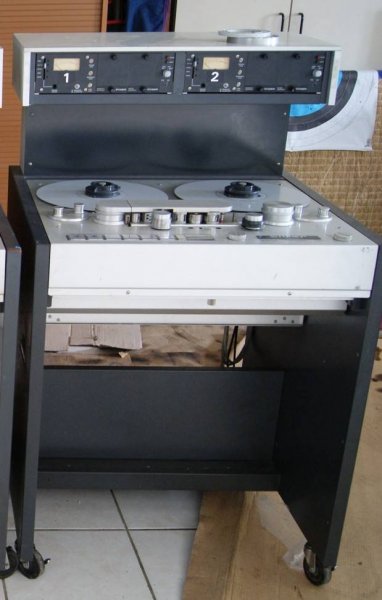

I'm not that familiar with the RC but AFAIK the R and RC are identical save for lay out. The R has a seperate card cage slung below the transport electronics while the RC has the same audio electronics next to the transport electronics. It is the A80 (VU) that is different.
Studer specs the same (200mH) repro heads for R,RC and A81R . Head specs for the A 80 VU differs wildely through the various models (Mark I -IV)
