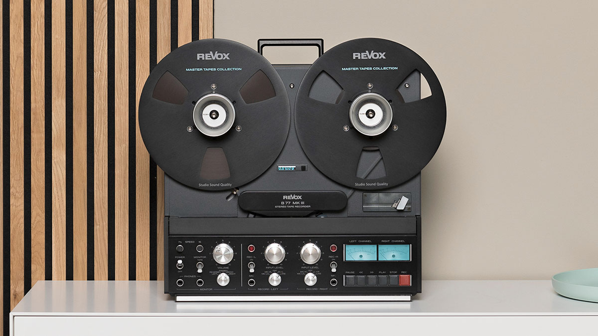

It looks like ReVox, as part of the release of its new tape machine, will be involved with releasing copies of tapes:
In the Revox KLANGWERK, Revox has now set up a copying line with a Horch House Master System consisting of professional Studer / Revox tape machines. Here, the exclusive master tapes with the original recordings from the recording studios are copied slowly and with the greatest care at 1:1 speed in the best possible quality. From October 2024, something very special will be created for tape lovers in Villingen. With the Revox Master Tapes, they will have the opportunity to enjoy the analog quality from the recording studios in their own living room, completely unadulterated and truly analog.
Revox thus unites the world of tape recorders and master tapes in an impressive synergy and uniqueness - only from Revox.​
