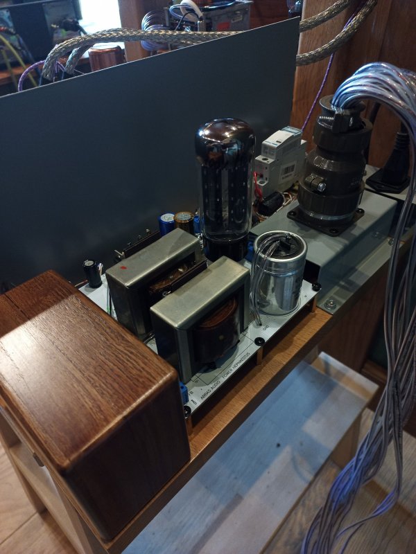

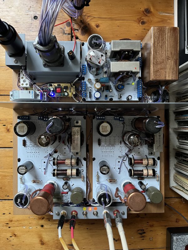

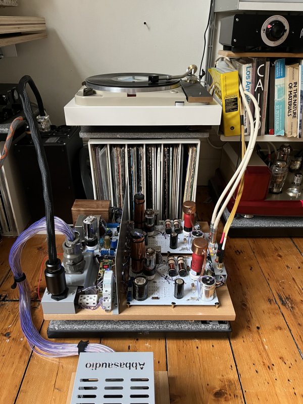

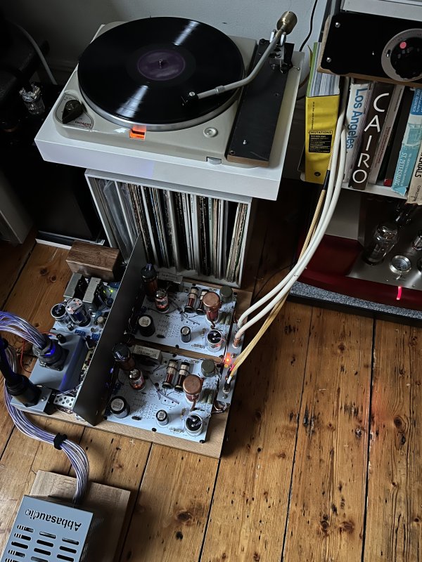

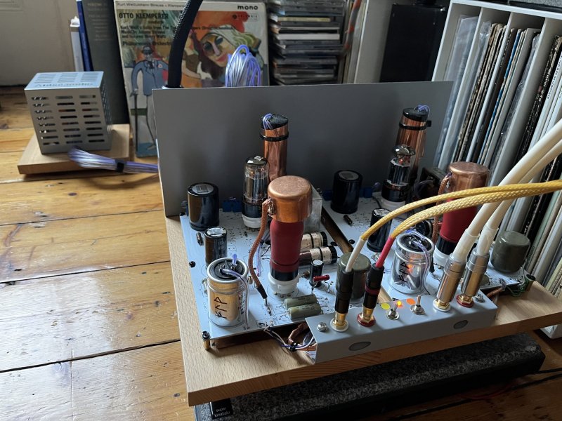

Abbas sent me nearly complete build photographs of my Hephaestus RIAA phono preamplifier. He is satisfied with its sound. From the sound and attention to detail of the two ABBAS instruments I presently use, it seems Hephaestus may very well develop an already magnificent achievement beyond compare. I have the half size EL 84 / EF86 phono RIAA, as well as DAC 2.4 SE signature, with rewound transformers and handmade caps. It is hard to imagine how much more beautiful vinyl could sound with this larger ABBAS device. Perhaps the new RIAA will offer greater scale and density of tone, and more.
