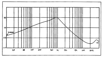

Some speakers present an extremely difficult load. Just for kicks lets' pick on the Apogee Scintilla. Not only could you get bad sound but you could experience some pyrotechnics with.

Those rules of the road are sometimes the subject of furious debate. Take my ML CLS. Rigorous adherence to the rules of the road would have caused me to have discarded it long ago. As I stated in another thread the amp speaker interface is very important. It remains one of life's most interesting aspects. Get one parameter right and the other falls out of alignment.
In my opinion, the reason speakers sounds so different with many amps is that the comparisons are often done with amps which cannot handle reasonably designed speakers. Well designed amps have high voltage capability, high current capability, low distortion, and a very low output impedance. That last factor is the major reason why some speaker/amp combinations seem so critical. Tube amps--all or most--have output impedances of one ohm or more. Stereophile's amp tests have long shown the frequency response variations caused by a dummy speaker load. For tube amps the variation can be plus or minus several decibels over a very wide range. Such variances are sonically obvious to anyone, not just audiophiles. Well-designed amps have very low output impedance which means that even when mated with speakers whose impedance varies wildly and may drop below 4 ohms at some frequencies, the frequency response of the amp varies by only a small fraction of a decibel. Sure, you may still hear some differences among such amps, but they will be audibly subtle.
Put all these requirements together and this means that most inherently good amps are high-power solid state ones, not low-power tube SETs, or even high-power tube amps. The real sound of your CLS speakers or any other speakers are the sound they have when driven by an amp of high power, high current, low distortion, and low output impedance.
I know forum members are tired of me discussing my system, But lets face it, they are an improbable match on paper. Sterophoile reviewed the 402au and found them to have an output impedance of .22 ohms and and a rise in distortion as the speaker impedance dips below 4ohms. http://www.stereophile.com/solidpoweramps/moscode_402au_power_amplifier/index4.html.
Lets put that toghether with ML CLS. CLSfig1..jpg http://www.stereophile.com/floorloudspeakers/650/index11.html Assigning the CLS an impedance of 4 ohms is being generous. 33 ohms at 1khz, 2.5 ohms at 10khz and 1.9 ohms at 20khz. Sterophile suggests avoiding speakers that dip below 4 ohms.
My listening experience makes them an almost ideal match. I even get excellent bass. Many have called the CLS edgy and and bass shy. One can assume I have no interest in a speaker that sounds that way. Manny ahve suggested that a solid state behemoth is the only way to go. They generally have very low output impedance and the ability to remain stable with complex loads. Such combos have left me cold or tend to be prohibitively expensive. So the question what's going. We can design a near perfect amp based on the parameters we know how to measure. But those devices have usually been found wanting musically. It is why stereo design is part science part art.
Finally I would suggest i would not even consider an SET with he big Wilsons. They must be a good match or why would Steve Bother. I'll be hearing them later this month and evaluate what's going on.
