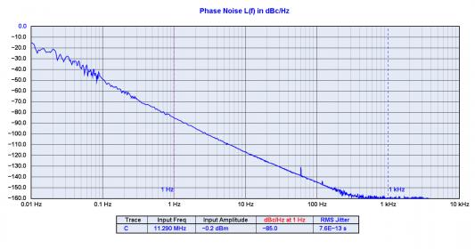

Yes. Very few folks have the gear to measure down that low. I think MSB measures down to 1hz. Here's a recent measurement he took of a sample Russian crystal.
Yea, looks pretty good (got a manufacturer/model for it?)but phase noise plots are frequency dependent i.e this is taken at 11.xxMHz - it could be very different at 22.XXXMHz
According to him, the more reliable figure to characterise clocks seems to be Allan Deviation.
