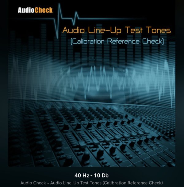

I can speak to this, at least partly. I have done several LoKe subwoofer setups and the ideal placement tends to be 2-6” (usually 4” is the best) away from the main speaker raked to an angle of the main speakers woofer, and a phase degree of 6-11 depending on type of amplifier, usually 6-7 for tube gear. You dial them in based on a click track.
The larger Chronosonic style woofers are designed to be placed on the corner back wall but similar setup procedures apply.
Reactions: Tangram
Usually a 40 hz tone and a 40 hz click track are used to set phase. The clicks become a solid thump when the phase angle is optimized.
Reactions: Tangram
