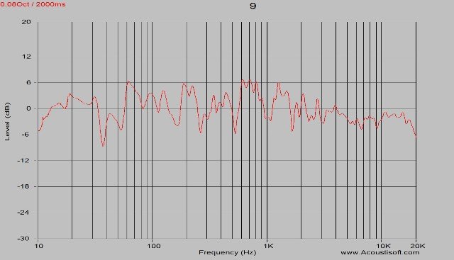

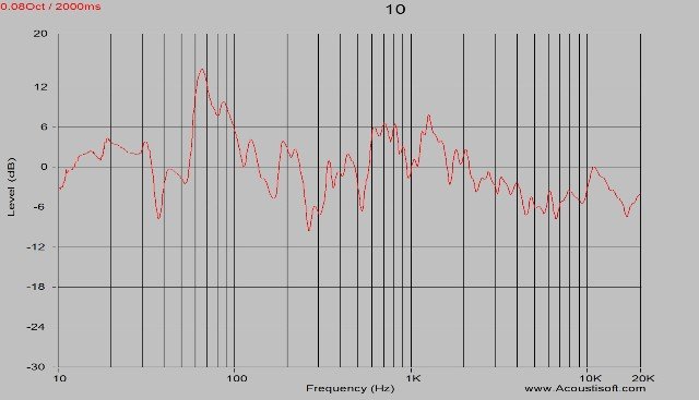

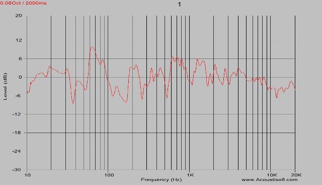

Read through the Audyssey site -- pretty impressive! I did not know Tomlinson Holman was involved, a big plus for me. We met a few times, though he would not remember me from so long ago (and, I had hair then).
For grins, here's what my room response looks like at the moment (always subject to change; 1/12th-octave):
First, no processing:
After running MCACC:
After manually tweaking:
