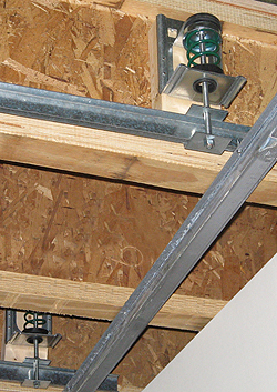

Still wondering if I should have mapped out a way to support the ceiling on the (floating) walls, but ran into code problems that would have cost me another foot of height and I didn;t really have it to give...
I used the Kinetics Noise control ICW spring hangers for my ceiling. I lost about 4" heigth.

That is probably what I should have done... I followed a friend's build and used the clips everywhere, but (despite their supposedly "universal" application) they do not provide sufficient isolation when used to mount a ceiling. They allow pounding from above to be transmitted through, though they seem to work OK isolating the room above from what's inside my media room. For various reasons it would have been harder to get our contractor to work with the hangers (he loved the clips, however) and it wasn't clear our inspector would pass the hangers for residential use (though I suspect we would have been fine).
