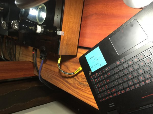

I implemented this possible solution using a 20 cms (8 ") Curious USB cable, following these two recommendations:
- From Wireworld, shorter is better.
- From Miska (HQ Player developer), protecting the cable from RFI, EMI pollution, where the construction & cable length is important.
I personally think that the reflections (due to cable length) should not be important because what are transmitted are packets in asynchronous operation. Of course very DAC dependent, the most commonly in modern DACs.
I've tried a lot of USB cables throughout the price range and this is the one I liked (subjectively, of course :))
I'm on HQ Player running on a Mac with a Windows laptop as NAA, which is the one shown in the picture, feeding a Lampi B7.

Roch,
Is that the secret password to your vast bank account holdings on the sticky attached to your laptop?
How are you liking the Kalugas? I've had mine for about 18 months and I love them!

Roch,
Michael.
Hi Michael,
Ha, ha, ha... no so vast after this hobby of us :)
I have two partitions in the Windows laptop, one for the Lampi and his ASIO drivers, the other for the exaSound DAC, so each password and partition number is stored in the sticky (that I forgot to remove for the picture).
I do love the Kalugas even without the warm distortion (or any) of the tube amp. But there are still some tubes in the chain, from the pre. and the Lampi. Also Kalugas drives CLX speakers with easy and I believe could be a better integration to the ML subs. that are Class D amplified too.
