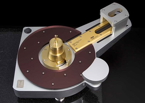

We are talking of AF0 with a platter of 54 kg,
and i think also this TT Horning Sati,with a platter of 50 kg is no bad,with a price list of 24.500 euro
Italian distributor is same of Techdas
He sold one,never compared with Techies but told me is very good
Reactions: 108CY and bonzo75

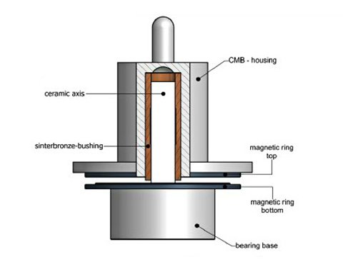

Can someone explain different types of bearings and pros and cons?

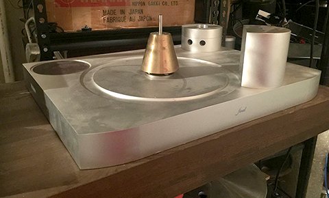

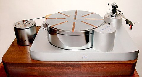

Merry Xmas Dave! Do you mean here that the thrust plate is intimately coupled to the platter so all the friction artefacts, generated during the rotation, reach the record more easily?
Cheers,
Merry Christmas Jarek!

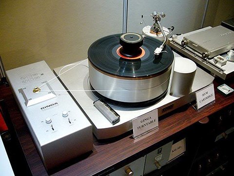

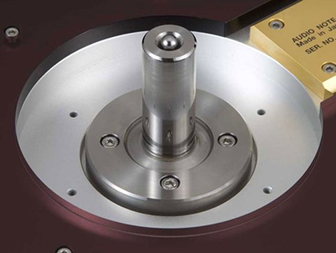

In a sense yes :), the inverted bearing design can sound quite nice and it's advantage is that it's simpler manufacture a higher quality than a traditional oil immersed bearing type, on the downside it's limited and there's only so far you go with it; IMO. Basically it's an upside down shaft with a ball bearing sitting on top, hence inverted and the bearing housing is sitting on top now under the platter. Here's the famous Final Labs Parthenon which is now AN Ginga's inverted bearing,
There's usually some kind of a hood with the built in dry bearing housing and a connected spindle for the platter to sit on.
In the absence of an oil bath some try to dampen the bearing and it's effect on the platter by using magnets which I don't find particularly effective but YMMV.
david

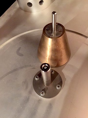

Thank you very much David for the explanations and the pictures. Your are right, the dry character of the inverted bearing is probably its most prominent feature (together with the non-inverted pendulum operation). Fantastic illustrations! I'm wondering why the complicated shape of the hood of the AN TT as compared to the original simple cone. Probably a thicker platter?
Cheers,
ddk
May 18, 2013
6,261
4,043
995
Utah
Cheers,
It's mostly a cosmetic evolution from the original Final Labs Parthenon that they started with and of course access to better machining.
david

The sati can sound very good especially in terms of control and scale with get nuance it is actually a very low grain turntable with a uncluttered midrange. Quite impressive for a simple design.
Reactions: marmota
