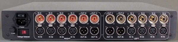

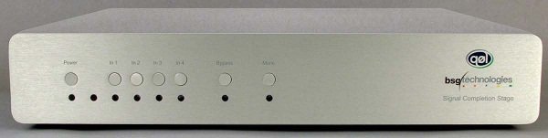

Had the opportunity to test out a BSGT "qol Signal Completion Stage" last night. I went to their website and tried to find out some information on what this box does. They charge $3995 and offer a 30 day trial.
BSG Technologies
Below is a photo of the unit. It sits between either your source and pre or the pre and amp. There are no settings besides on and bypass. I was listening to its effect and found I could recreate the same exact effect by using the mid/side settings on my console. It does increase gain and brings up all the "side" information from about 125Hz and above. I had put an SACD in my Playback Designs and also had the ripped DSD information in my Sonoma workstation and going through an analog loop from the console. I matched the gain and did quick A/B comparisons to see if I could emualte the effect. Anyone could do the same exact thing using a L+R/L-R/Mid algorithm.
That's it....??? For $4k? The company says it's completely analog, no digital processing and the company says the "qol" effect is patented. The effect reminds me of an exaggerated Q-Sound.... very phasey! Seems this is the only component that they make. Me thinks you need to save your money....

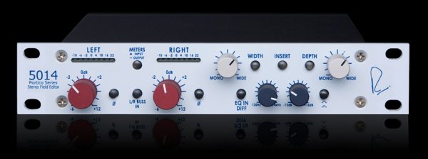

For a much cheaper (and better) alternative, use the Rupert Neve Stereo Field Editor. The effect is variable where you have greater control over the effect. Also, you can vary the depth and other cool features.
Rupert Neve Portico 5014 Stereo Field Editor

The bad thing is they claim it's an ambience/music recovery system:
"we have simply found a way to extract information already present in recordings, but otherwise hidden in conventional reproduction. Our technology enables COMPLETE capture, transmission, and reproduction of such information, including elements that, until now, have remained hidden and buried in electronics, and unavailable to the listener"
All it is is a stereo field editor that mixes in an out of phase signal. You can see it on the o-scope demo they have on their site.
[video]http://www.bsgt.com/technology-information/oscilloscope-view-of-qol/[/video]

Thanks Bruce. The Rupert Neve looks like it might be fun to play around with. There are QOL users out there who are quite taken with it's effect. It appears the Neve would give one more precise control over how much or how little they wanted to introduce the effect and adding gain isn't mandatory as it appears it is with the QOL. I'm probably going to get one just for the fun of it and to learn something. (technically challenged user so always like learning something new)

Congrats! You'll have lots of fun with it, that's for sure.

I'm not sure if feeding the rear L+R speakers some manipulated output from the Portico 5014 in conjunction with the unaltered stereo signals to the front L+R speaker system would recreate something better sounding than the typical DSP processing in A/V receivers for surround sound. So for someone with a multichannel audio system, what is the best way to create surround sound from stereo analog or digital sources?

Bruce, it doesn't seem as though arthurs pursued the Rupert Neve Portico 5014. However I noticed that the pro audio 5014 has balanced I/O. What are your recommendations for connecting the 5014 between a consumer audio preamp and amp that both have unbalanced RCA I/O? In your opinion will the complexity of such connections with the 5014 diminish the "QOL-like" sonics that have been praised in several reviews?

Not a problem since it has gain adjustment. With good solid connections, you will still enjoy the full effect.
