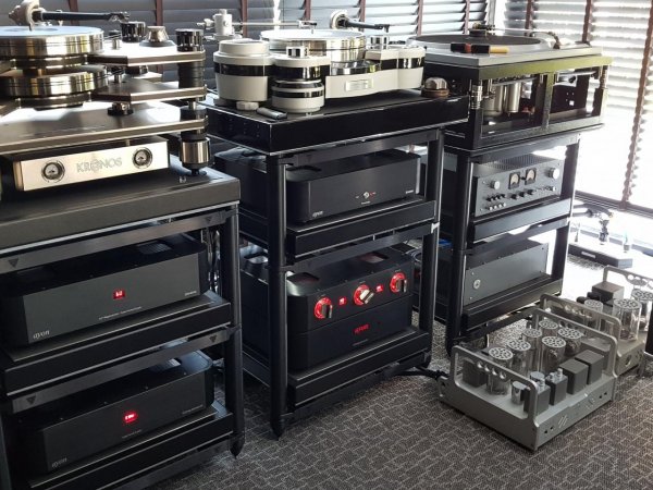

I have many phono cables. My RFI problem comes when I position my phono cables in a wrong place.

Tanh, what do you mean by in the wrong place? Near other wires or power cords?

Not the power cables. I have a big glass window. The RFI comes from the public radio station nearby. Placing a my phono cable a foot to the right can capture RFI. One of my phono cable I even have to scotch taped to the left leg of my rack to get a complete absent of rfi. It is annoying I understand. I had to play around quite a bit. If you look at the latest pic of my syste, you will see that I have moved my EMT to the right and move AF1 in the middle. This position somehow gives me no RFI. In the back of my system you will see a big glass window.

I see. You have a lot of great looking and sounding equipment!
