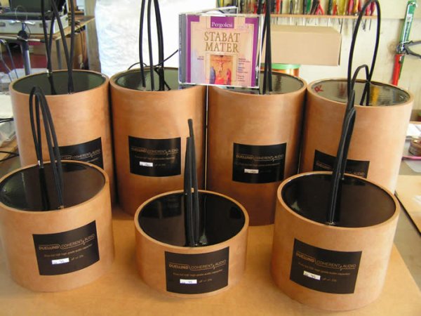

Try stuffing these into your tape preamp...or stuffing your preamp into these caps. Big MF's :)

Thanks for posting that info - I did not actually get that section of e-mail exchange here and just scoured my in-box to double check.... My testing so far did not show any sign of low frequency rolloff without that 470uF cap and that is what I expected to see when I yanked it out. Once I get time for another round of checking I will dive in and do some more testing then report back.
I have some 10uF dueland caps around here - I used them to protect a line of ribbon tweeters on a line array here - and although they won't fit inside they would be fun to try anyway. The ones I have are flat copper foil types as I recall and not as wild looking as those ones Myles posted!
BTW - since this coupling cap is at the input to the stage (first thing the signal rides through after the jacks) space is not necessarily an issue - we could locate that coupling cap outside the box at the input to the tape stage and simply wire it in series with the cable from the tape heads. Bit silly but it would not be the first time a diy audio experiment got silly.
Thansk!

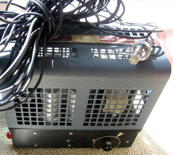

Futterman and E.D. Nunn(Audiophile Recordings) might disagree about transformers being superior. The Futterman originals on the right speaker(Quad 57s or KLH 9s) are simply stunning and lifelike. The Audiophile record label was owned by Nunn and he was the recording engineer and producer. He could afford anything he wanted(heir to Nunn/Bush show empire) and he decided to design his own microphones with line level output and NO transformers. He used these from his earliest stereo recordings(AP-56 Muskrat Ramble) and the famous AP-66 'Yellow Dog Blues'(HP list). Nunn utilized the B&K instrumentation 1/2 inch capsules(a Mark Levinson Favorite as well) and an innovative RF circuit with one tube. There is a fine article in an old TAS about Nunn and his recordings. He was a true American Original, as was Futterman. I now own the Nunn microphones and Charlie and I hope to get them up and running for some recordings this fall.
Charlie should chime in about the input capacitor in the K/C preamp in a day or so. I'm not a tech person, so I'll leave it to him or John Chapman to explain(hopefully in Layman's speak) the need for a capacitor.
A great transformer(big Partridge with Ortofon SPU or Koetsu Rosewood with Cotter/Verion) can also be a way to sonic Nirvana. More than one way to reach that goal....
