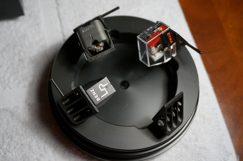

Kuzma makes a cool storage container for extra headshells with cartridges mounted. I call it the Kuzma Roundhouse.
Cartridge Roundhouse open.png I have two of these. Nice quality.
View attachment 79611 I have two of these. Nice quality.
Are you having difficulty acquiring a 4Point armboard?
