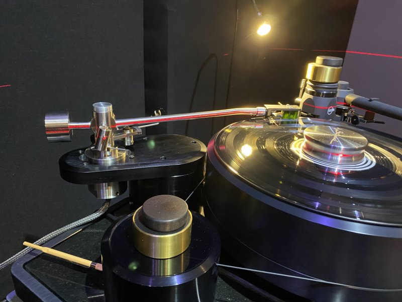

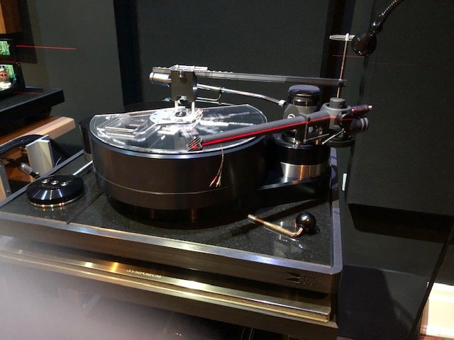

I use a laser on a microphone stand along with the acrylic gauge mentioned above.
Reactions: Bonesy Jonesy
Thank you 'Kcin'. Much appreciated.
I was thinking along similar lines this morning with using a lazer light along the tonearm arm ;)
Reactions: Kcin
